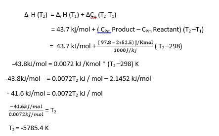

Organic life is based on complex organic molecules formed from smaller ones during a long evolution. Using data in Appendix 2, investigate one such reaction:
2 C2H6 (g) → C4H10 (g) + H2 (g)
(a) Calculate ∆rH and ∆rS for such a reaction under standard conditions (Po = 1 bar, To = 298 K).
Is there a temperature, TH, for which the reaction is neither endo- nor exothermic – calculate it?
- I did this already - The ∆rH = 43.7kJ/mol which is needed to answer the next question
b) Is there a temperature, TH, for which the reaction is neither endo- nor exothermic – calculate it?
CPm(C2H6) = 52.5 J/(mol K)
CPm(C4H10) = 97.5 J/(mol K)
Smo(C4H10) = 310.2 J/(mol K)
∆fHmo(C4H10) = -125.7 kJ/mol
Δr H (T2) = Δr H (T1) + ΔCp (T2-T1)
Did I do it right? is it possible?
You've used "H" for "hot," for "hydrogen," for "enthalpy," ... ?
Your algebra for the heat capacity term doesn't seem correct, and you omitted the effect of the heat capacity of hydrogen.
But - in general - the answer to the main question is "yes".
enthalpy

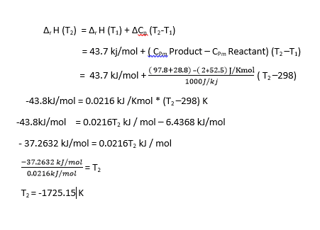

oh yeah, I totally missed that.
does this number seem reasonable ?
I think so. So, for this reaction, there apparently isn't a cross-over.

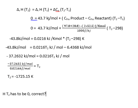

in a follow up question I was asked "obtain the reaction entropy, ∆rS, for such a temperature" (which I calculated to be -1725.15k)
So I tried using this:
Δr S0 Tf= Δr S0 Ti + Δr CP ln(Tf / Ti)
but I can't do ln for a negative number so is my temperature calculation wrong?
As best I can tell, you didn't make a mistake.

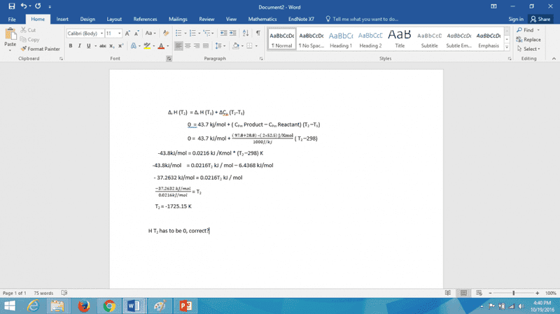

okay, thanks for replying again. Just one more thing, at negative temperature is the entropy 0?
Because I can't do ln for a negative number.
I used this equation : Δr S Tf= Δr S Ti + Δr CP ln(Tf / Ti)
To my knowledge, there is no such thing as a negative absolute temperature.
