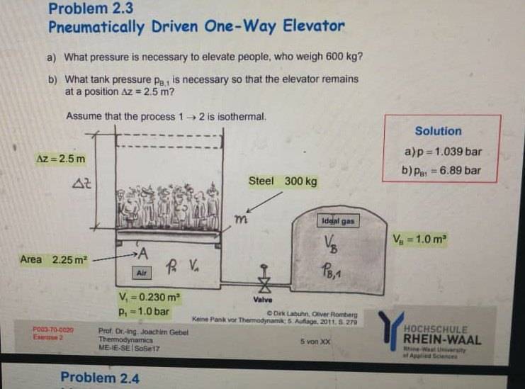

michealyap
42
area=2.25
p1=1bar
v1=0.23m3
p2=
v2=1m3
Isothermal process W=nrt ln(v2/v1)
W=F*D
I got the workdone then sub into the equation of isothermal process. i couldn't get the answer right

Good morning from CEST. Thanks for posting your question to the right forum and using the template. However, we cannot see what you've achieved so far and what you've done, so please show your work or explain your thougts more accurately. The picture you attached shows two questions to solve, a) and b). Have you solved one of them or are you stuck on the first one? By the way, you don't need to calculate the work done to find the answers.
I have already solved the first question. a) i take the formula of P=F/A the total weight of is 900kg, to get the F, i multiplied 900kg with the gravity acceleration,9.81 m/s2 , area is given, 2.25m2 . Then substitute into it, i got 1.039bar.
For question b, i need to calculate the p2 to maintain the lift in the mentioned height (2.5m) . First i get the work done first W= F*D , after i get the workdone, i substitute the value into the isothermal process equation W=nRT in(v2/v1) , by comparison with the another equation, W=nRT In (p1/p2) then i can get for p2. But the answer i got was incorrect.
You neither know the ##R## nor ##T## nor ##n## (or ##m##), so you introduce more variables than you obtain equations. If I've understood correctly, you want to solve
$$ mg\Delta z = nRTln\left(\frac{p_1}{p_2}\right) = nRTln\left(\frac{v_2}{v_1}\right) $$.
What result did you obtain?
Try to solve it with state variables only. Do you know the correlation between pressure ##p## and volume ##V## for an isothermal process ##T=const.##?
I understand the relationship of pressure p and volume V for isothermal process. P1V1 = P2V2. In the question i know V1,V2, and P1 i take as 1.039bar. Then ended up P2 is a wrong answer.

That's because you don't take into account mass conservation, but in ##V_2## will be more mass than in ##V_1##, since molecules will be transferred from the tank. Can you express the mass (or moles) contained in the tank and in the room below the platform for the initial and the final state by means of ##T##, ##p##, ##R## and ##V##?
I am confused now. Initial state, does it mean that the gas in the tank and in the room is already mixed but the lift is just about to be lifted?
if that is the case mass in the room + mass in the tank = p(eqilibrium) *V / RT . but what is the R in here?
Mass in room + mass in tank = Pr1*Vr1 / RT + Pt1*Vt1 /RT - Initial state.
Mass in room + mass in tank = Pr2*Vr2 /RT + Pt2*Vt2 /RT - final state
At here we know Pr1,Vr1, Vt1, but we don't know Pr2 and Pt2 and Pt1.

That already looks quite good:
$$m_{t\,1}=\frac{p_{t\,1}V_{t\,1}}{RT}$$
$$m_{r\,1}=\frac{p_{r\,1}V_{r\,1}}{RT}$$
$$m_{t\,2}=\frac{p_{t\,2}V_{t\,2}}{RT}$$
$$m_{r\,2}=\frac{p_{r\,2}V_{r\,2}}{RT}$$
mass conservation gives us $$m_{t\,1}+m_{r\,1}=m_{t\,2}+m_{r\,2}$$

I disagree: we know ##p_{r\,2}## and ##p_{t\,2}##.

We DO know ##p_{r\,2}## and ##p_{t\,2}##. First of all, they must be equal, after the platform was elevated by ##\Delta z##. Secondly, the weight of the persons on the platform didn't change, neither did its area. The force applied by them on the platform must be identical.

Then let's solve that question first: What pressure is necessary to elevate people who weigh 600 kg? That should give us ##p_{eq}##.
a) How i do it P=FA = 900kg * 9.81/2.25 = 3924 Pa since Pr1 is 1.0 bar the and the elevator is not lifted. so the pressure necessary to elevate is 1.039 bar. which i presume is Pr1.

So, if the weight of people and platform and the area of the platform don't change, why should a different pressure be needed to compensate their weight? ##p_{r\,1}=p_{eq}##
Yes.. You are right. Wao.. This is amazing.. I thought when it reached equilibrium the tank will also have the same pressure as the room..but why we can assume pt2 to be same in the room pr2.

The tank and the room will have the same pressure, as you stated two posts (#12) earlier: ##p_{t\,2}=p_{r\,2}=p_{eq}##. Maybe we have a different interpretation of the questions. I read it like this:
1) There is a platform with people on it, below the platform there is a reservoir of ideal gas. There is a equilibrium af forces between the weight (of people and platform) and the pressure in the reservoir. Calculate the pressure in the reservoir.
2) The reservoir is connected to a tank via a pipe with a valve, initially the valve is closed. After opening the valve the platform is elevated by the incoming ideal gas, before the equilibrium is established again. Assuming an isothermal state of change of the ideal gas, calculate the necessary (initial) pressure in the tank to lift the platform by 2.5 m.

For 2) I interpreted as what is the pressure need to be maintained , but not to elevate the lift.
Based on your interpretation, I fully understand what we have been.doing..
... and I'm confident that my interpretation is correct, since the result matches the one of your professor.
Alright.. really appreciate your explanation
