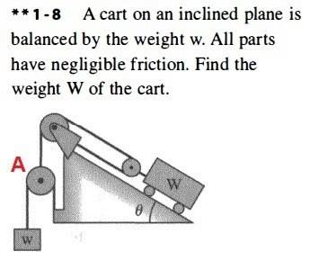

$$\sum_i m_i g h_i = 0$$
Moving the pulley I labeled A down by ##\delta y## moves ##w## down by ##\delta y##, and moves ##W## up by ##\frac{1}{2} sin\theta##.
So by conservation of energy I have $$-w\delta y + \frac{1}{2}W \delta y sin\theta = 0$$ leading to ##W = \frac{2w}{sin\theta}##.
I feel uncertain about this answer however, because it seems like the mechanics would be the same if you removed Pulley A and replaced it with ##w##.
showzen said:
Moving the pulley I labeled A down by δy moves w down by δy
Are you sure about that?
Not sure why you are using virtual work either. I would attack this problem with mechanical advantage of a system of pulleys.
Regards,
KQ6UP
My reasoning here is that if pulley A is moved down to be even with the anchor point, ##w## will have dropped by the initial length between the anchor and the pully.
showzen said:
My reasoning here is that if pulley A is moved down to be even with the anchor point, ##w## will have dropped by the initial length between the anchor and the pully.View attachment 104192
I see my mistake now! ##\delta y## moves ##w## by ##2\delta y##. So ##W=\frac{4w}{sin\theta}##, which is what I get from force analysis as well.
That looks good.
