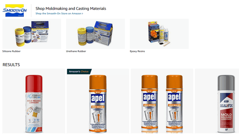

I'm trying to make a mold because I want to add something to some jewelry. I 3D printed the symbol that I wanted, and tried to make a mold with Plaster of Paris. But I can't take the print out of the plaster, and I don't want to damage it with a knife. I'm thinking ethyl acetate? A quick google search says it melts PLA, but I don't know what it does to plaster. Anyone have any ideas?

Could you try it again and use a mold release compound to make it easier to take apart?
berkeman said:
Welcome to PF. :smile:
i don't think i have access to that :(
Why not? There are lots of mold release agents/compounds, including some that you can make for yourself. And Amazon has plenty of choices...
https://www.amazon.com/s?k=mold+rel...ture-scomp&tag=amz-mkt-fox-us-20&ref=aa_scomp

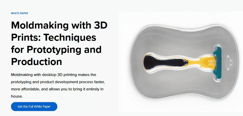

Hey wait a minute... Can you just 3D print the negative halves of the item you want to mold? In essence, 3D print the 2 halves of the mold and use it (with mold release compound!) to mold whatever your symbol/thing is.
https://3d.formlabs.com/moldmaking-...XPwhF9gGK1-cQcgnhePLgeABHGjJkFowaAh3IEALw_wcB
You can also print in PVA and use water to dissolve it.
