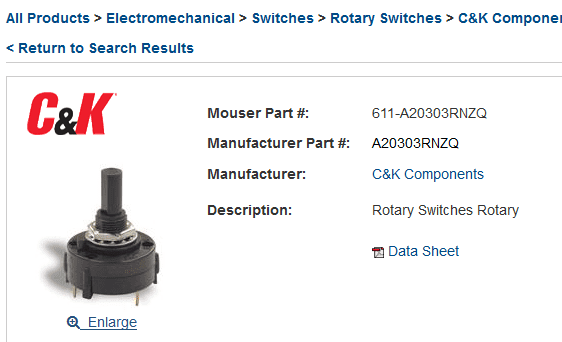

this three position switch
http://www.mouser.com/ProductDetail/CK-Components/A20303RNZQ/?qs=sGAEpiMZZMvNbjZ2WlReYqS7wnWG8l9O54StjK1Q2yQ%3d
Mouser product listing for C&K Components rotary switch, part A20303RNZQ, with a photo of the black rotary switch with a shaft and three solder pins.
wired to a connector that mates with the stator plug
will let you select the phase to be measured.

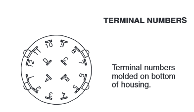

http://www.mouser.com/ds/2/60/A_Rotary_30juyl14-38283.pdf
Circular diagram of a 12-position rotary switch with terminals numbered 1 to 12 around the rim, labelled TERMINAL NUMBERS, with the note: Terminal numbers molded on bottom of housing.
except it won't have terminals B and D

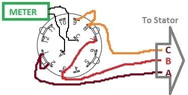

here's how to wire it
Wiring diagram of a rotary switch with a green METER label at top left, wires from positions 1 to 6 running to terminals labelled C, B and A under the heading To Stator.
on the front panel of whatever you mount it to
Label position 1 AB (or 1-2)
Label position 2 AC (or 1-3)
Label position 3 BC (or 2-3)
