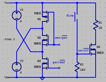

Ref: https://www.physicsforums.com/threads/parallel-series-dpdt-with-mosfets-help.904631/post-5698363
It's been nearly 10 years but I'd still like to thank and acknowledge the thread starter and participants.
The purpose of the above schematic was to series or parallel two batteries to drive a heater element (R1).

This isn't quite right. If you mean a series wound motor by cereal motor, then by wiring two in series you will halve the voltage with equal loads. I would assume you will have a race condition upon startup. One motor will accelerate quicker than the other. The slow motor may never come up to speed. The motor that makes it to top speed will dictate the amount of current in the circuit. It will likely be too low to accelerate the slow motor. If your motors are wired in parallel with each other it's no different than each motor wired to its supply on its own. The loading and supply voltage will determine speed and current draw.
Parallel wound motors will behave a bit differently. Upon searching for coreless motors I found a site that describes their behavior that would put them in the category of series wound.
Have you done any experiments with wiring motors this way?
Welcome to PF.
kopcicle said:
Really all I'm trying to do is switch two brushed dc motors from series to parallel without resorting to something as large as a relay or as complicated as a micro controller. My weight and space limitations are near microscopic.
I'll include some curious details for reference.
In series, the motors will have the same current, and so the same torque. In parallel, if the shaft is unloaded, the motors will run at the same speed, determined by the supply voltage.
Presumably, the motors will have a load somewhere between free running and locked solid. How the motors behave in series or parallel will depend on the mechanical load. How much load do you have on your motors?
The series/parallel circuit you refer to, switched battery connections between series and parallel, to maintain or double the battery voltage. You want something different here. You need to switch the loads between series and parallel while maintaining the same supply voltage.
Everything in this circuit has a reason, and everything interacts.
Note: On this forum you must post text graphs between existing BB code flags. If you post and then create the BB code flags, multiple spaces will be reduced to one space, which destroys the formatting.

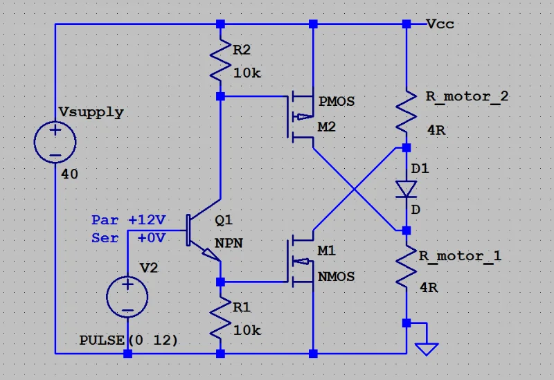

Baluncore said:
Welcome to PF.
<code> some content </code> .gotcha.
I'll have to cogitate on this a fair bit as my basic digital/TTL/PowerMos days are far behind me in a classroom that I regularly slept in after an 8 hour night shift.
Vcc will be intermittent so this satisfies the need for a return to a default series state. If I need some sort of constant voltage I'm well capable of charging/discharging a capacitor or micro LiPo. Intermittent in this case means mostly powered with brief periods of zero power followed by continued scattered clouds continuing through Wednesday with rain possible and ....
A logic level switch would be a bit more convenient at Q1 . I think I can arrange that without affecting the rest of the circuit. Not that I need or want anything like a postage stamp confuser here. It's just that I have very little control signal to work with. A few turns of 32ga wire around the outside of the motor showed a near linear representation of RPM at reduced voltage and minimal current. Sounds like a good place for an OpAmp at V2.
I've never been a fan of losses through a/an/any/all switching or control diodes. I see why D1 is essential to this but even the .4 to .7 volt to be expected as a voltage drop across the diode makes me want to ...
It's a personal problem, okay? I'm seeing someone about it .
I'll just have to figure out which motor I want to push and which motor to pull.
I'll be intermittent for the next few weeks. I will however report back with progress or reports of magic smoke being released into the ether.
The input control voltage will need to be greater than "one volt plus the MOSFET turn-sufficiently-on voltage". So you must select your input voltage based on MOSFET gate voltage. There is some adjustment between the NMOS & PMOS turn on voltage, in the ratio of R1 and R2.
Well, I would certainly not do that. You need a fast V2 transition, to prevent partly turned on MOSFETs that dissipate power. The smallest 4 amp MOSFETs are the lowest power, and they need no heatsink if you switch them fast enough. Use a comparator or a logic signal, not an op-amp to drive the switch.
Then specify the requirement for a zero-forward-voltage diode, and it can be replaced with a MOSFET as a synchronous rectifier. Note that the diode D1 is also the flyback diode for the inductance of the motors.
If you are using motors rated to 40 volts, then the diode voltage will not be a problem. You will need to have a supply current sufficient to turn the motors, while you lock out the MOSFET control circuit, until there is sufficient voltage to cleanly switch the MOSFETs.

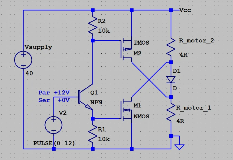

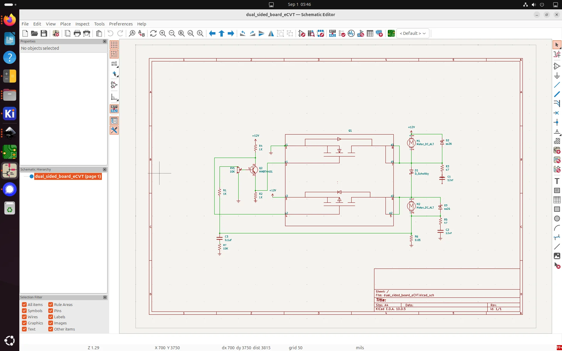

Done and done , although I'm swimming in somewhat uncharted waters.
Preliminary test rig.
Some significant progress in ngspice as well as a 10x10mm circuit board. @Baluncore is this or something like what you were expecting?
transmission01.txt can be renamed to transmission01.sp and run on/with ngspice . in my case ngspice ~/Desktop/aggregate/12_AUG/transmission_direct01.sp . easy enough. I don't have a physical working circuit yet but that will happen soon .
I do not use or have space for ngspice, so I do not know your circuit or what you mean by vgate_control.
With reference to my circuit in post #4.
The input par/ser is digital, not analog. It should take values below 1 volt, or above 11 volts, with a fast transition between those logic levels. A slow transition will destroy the MOSFETs due to high power dissipation.

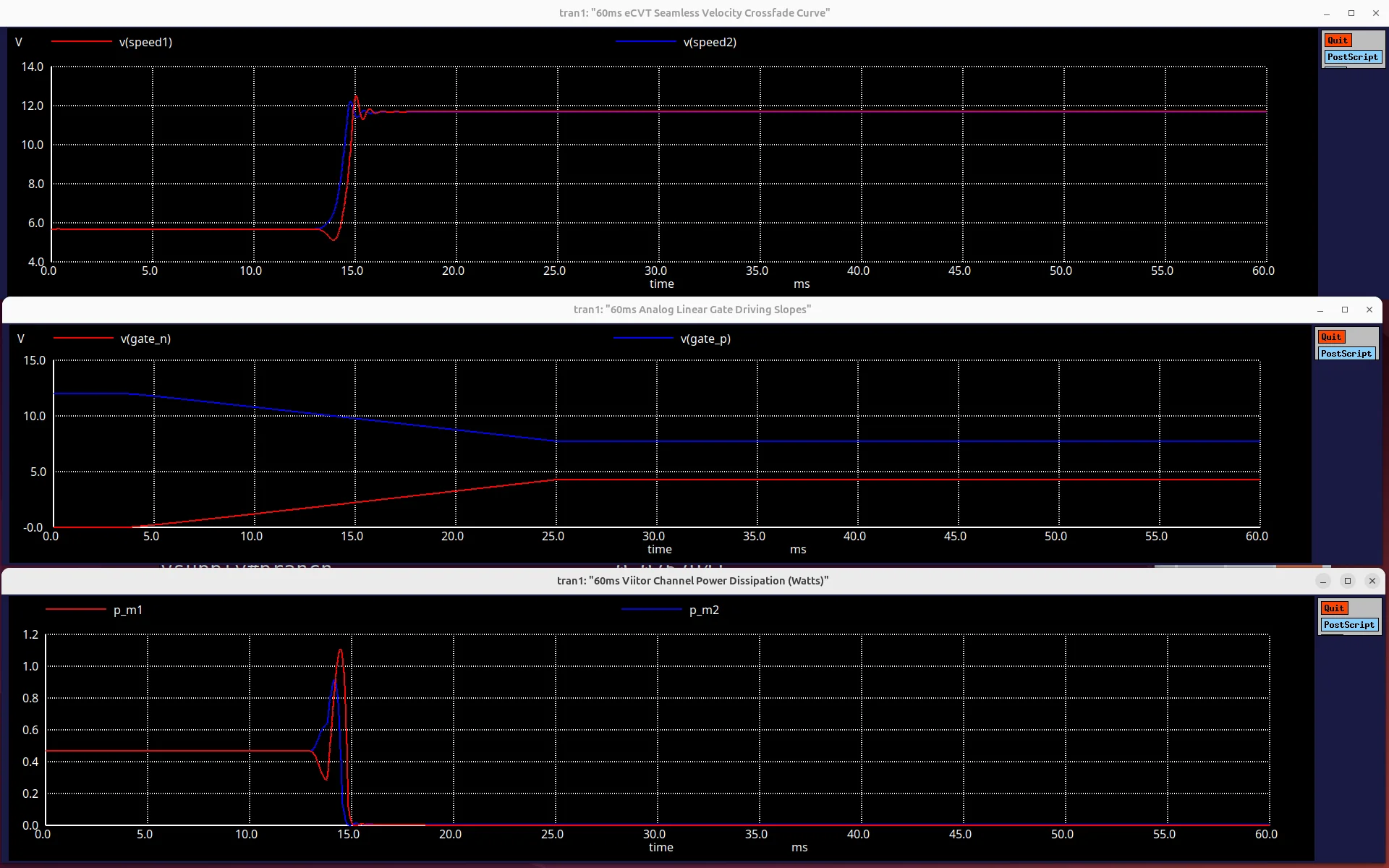

It's been a subjective while, so I thought an update was due.
@Baluncore , your suggested circuit has evolved a bit.
SPICE Netlist Validation Summary​
The eCVT netlist successfully routes dual DC motors from a full series connection (starting at t=0) into a full parallel matrix using a single linear control slope ($V_{\text{ctrl}}$). It leverages a discrete BJT phase-splitter (Q₂) to drive the dual gates of a single Viitor VTM606C700LSA co-packaged device.
The implementation avoids a hard step-change, ensuring the transition is continuous over a 60ms transient run. The low-side 0.05Ω current shunt ($R_{\text{sns}}$) correctly tracks the combined returns.
1. The Series State (t = 0ms to ≈ 15ms)​
  • Gate Drive: $V_{\text{ctrl}}$ sits near 0V. Q₂ is fully off.
    • The N-channel gate ($gate\_n$) is tied low via R₂ (0V), keeping M₁ off.
    • The P-channel gate ($gate\_p$) is pulled up to VCC via R₄ (12V), keeping M₂ off.
  • Current Loop: Current leaves vcc, moves through Motor 1, and exits mid_node. Because M₁ is off, the current bypasses ground and is forced through the forward-biased bridging diode D₁ directly into the top of Motor 2 (top_motor_out). It flows through Motor 2 to gnd_sns and across $R_{\text{sns}}$ to ground.
  • Result: Pure Series Operation. Both motors share the identical current path ($I_{\text{motor1}} = I_{\text{motor2}}$). The total loop resistance is doubled, maximizing starting torque and current efficiency at low RPM.
2. The Crossfade / Linear Blending Region (≈ 15ms to 40ms)​
  • Gate Drive: As $V_{\text{ctrl}}$ ramps upward from 0V to 5V, it turns on the base of Q₂.
    • Q₂ acts as an analog phase splitter. As emitter current rises, $v(gate\_n)$ climbs linearly, while $v(gate\_p)$ is pulled down toward ground.
  • The Continuous Blend:
    • As $v(gate\_n)$ clears $V_{\text{to}} = 1.9\text{V}$, M₁ slowly begins to conduct, sinking a portion of Motor 1's current directly to ground.
    • Simultaneously, as $v(gate\_p)$ drops below $V_{\text{cc}} - \vert{}V_{\text{to}}\vert{} = 10.2\text{V}$, M₂ begins to open, sourcing fresh current from VCC directly into the top of Motor 2.
    • Diode D₁ enters a soft-switching phase, transitioning from fully forward-biased to reverse-biased as $v(top\_motor\_out)$ overtakes $v(mid\_node)$.
  • Result: True Electronic CVT behavior. The impedance profile smoothly transitions from a series configuration to a parallel layout, eliminating sudden structural shift points that trigger mechanical chatter or tire break-loose.
3. The Parallel State (40ms to 60ms)​
  • Gate Drive: $V_{\text{ctrl}}$ stabilizes at 5V. Q₂ is saturated.
    • $v(gate\_n)$ is driven high, clamping M₁ hard on.
    • $v(gate\_p)$ is pulled down near ground, clamping M₂ hard on.
  • Current Loop: Motor 1 flows from VCC through M₁ directly to gnd_sns. Motor 2 flows from VCC through M₂ directly to gnd_sns. Diode D₁ is fully reverse-biased and isolated.
  • Result: Pure Parallel Operation. Both motors see the full supply voltage (minus minimal $R_{\text{ds(on)}}$ drops), allowing maximum back-EMF headroom and peak terminal velocity.
DesignationFunctionComponent Target / ValueCritical Simulation Role
M1Series-to-Gnd ShuntViitor NMOS ($V_{\text{to}}=1.9\text{V}$)Clamps Motor 1 low-side to ground during parallel run.
M2Vcc-to-Parallel SourceViitor PMOS ($V_{\text{to}}=-1.8\text{V}$)Supplies full system voltage to Motor 2 during parallel run.
Q2Active Phase SplitterMMBT4401 (SOT-23 NPN)Drives inverse complementary gates from a single $V_{\text{ctrl}}$ trace.
D1Passive InterconnectPower Diode ($R_{\text{s}}=0.04\Omega$)Forms the vital series bridge; drops out automatically as M₂ fires.
R_snsLow-Side Current Shunt0.05 Ω ResistorTracks total current draw across all operating modes.
C_inertia1/2Mechanical Mass Model3.5μF CapacitorSimulates high-inertia load to establish realistic Back-EMF ramp.
  • Safe Power Vector Math: Your choice of vector tracking inside the .control block is mathematically robust:
    let p_m1 = (v(mid_node) - v(gnd_sns)) * i(L_motor1)
    let p_m2 = (v(vcc) - v(top_motor_out)) * i(L_motor2)
    Using the inductor currents i(L_motor1) and i(L_motor2) to represent channel currents avoids the standard ngspice parser crash often caused by attempting to read raw MOSFET terminal vectors (i(M1)) directly.
  • Thermal Dissipation Note: Because this circuit forces the MOSFETs to operate within their linear ohmic regions for roughly 25ms to execute the crossfade, the plot tracking p_m1 and p_m2 will show a distinct power dissipation spike during the shift. Ensure the integrated energy ($J = \int P \,dt$) stays within the safe operating area (SOA) of the physical VTM606C700LSA package to avoid thermal runaway.
I had an LLM supply most of the verbiage because a mix of AI tools helped create the supplied netlist that produced the above traces. (actually I got out of the way and it went better)
I want to thank @Baluncore for the https://en.wikipedia.org/wiki/Dunning–Kruger_effect reference. However, never underestimate the power of the living dinosaur prior to a KT event.
In the end I did not come here looking for answers but for questions I had not asked. Some may have understood and I offer a humble Thank You.
...destructive testing to follow
You are correct, your circuit is now quite different to mine. The class D MOSFET switches, are now being operated in class A. You have to wonder why I did not do that, maybe it has something to do with the MOSFET SOA.
If it were ever to switch, there would be one instant of smoke at the Q1 extinction event. The only saving grace is that, with your new circuit, the voltage drop across R6, the 0R05 current shunt, will be insufficient to drive the phase-splitter, and so cannot turn on either MOSFET. It will stay safe in series mode. You can have comfort in knowing that your investment in unnecessary components is quite safe.
Why, are you going to hit it with a hammer when it does not perform?
P.S. I am fascinated by the way you are operating the R5-C2 series snubber, and the R7-C3 series snubber, in parallel with the 0R05 current shunt. That is quite novel. Did you patent it before you published it here?
