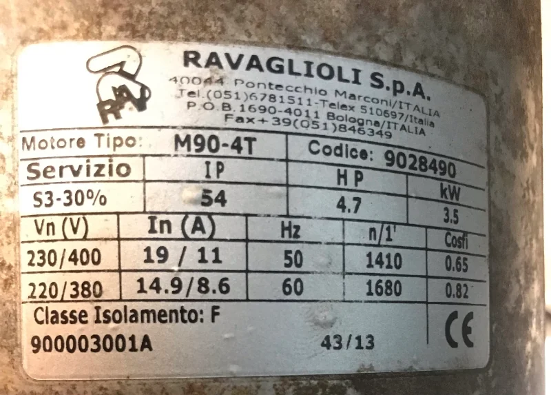

Motor plate, for interest:
Motor nameplate from Ravaglioli S.p.A. reading Motore Tipo M90-4T, Codice 9028490, Servizio S3-30%, IP 54, 4.7 HP, 3.5 kW, Classe Isolamento F, with 230/400 V 19/11 A 50 Hz 1410 rpm cosfi 0.65 and 220/380 V 14.9/8.6 A 60 Hz 1680 rpm cosfi 0.82.

As a first attempt, looking at the motor plate (connected in star):
$$Z=\frac V I = \frac {400} {11} = 36.4\Omega$$
Find capacitor with Xc of that value at 50Hz:
$$ C = \frac 1 {2\pi f X_c} = 87\mu F$$

The impedance of the motor is; Z = R + j X.
You should not try to neutralise the in-phase real power component.
Ok, so a cosphi of 0.65 gives an angle of 49.5 degrees:
$$Z=36.4\Omega <49.5° = 23.6 +j27.7\Omega$$
$$C=\frac 1 {2\pi f 27.7} = 115 \mu F$$

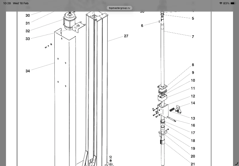

Could you post one or more pictures of the mechanical part of the lift?
Perhaps we can spot a source of high frictional loss.
The screw is on the right, and turns the other screw via two 90deg gearboxes and a driveshaft under the lift area. The lift nut is no. 19 and it lifts the squarish bracket (12), which in turn lifts the carriage with the arms that contact the car (not shown). Above all that is the autolubricator (8-11).
Number 21 is a safety nut, which normally carries no weight, but is there in case the main nut strips. If this happens, the linkage releases pawl 14 which engages with a stop on the column, preventing the car from being lifted.
Exploded parts diagram of a car lift column with numbered parts 5 to 34, showing the screw, lift nut, carriage bracket, autolubricator and safety nut.
I’ve renewed the phosphor bronze lift nuts and nylon carriage slides, and generally given everything a strip and clean/lube. I can turn the whole mechanism (unloaded) by hand via the screw pulley - it’s not easy but I wouldn’t say it’s binding. The screws do get hot in use.
It is an inefficient machine, but I guess this doesn’t matter since it’s only running for seconds in the hour. The manual specifies a 7.5kVA supply, presumably related to this and the huge inrush required when lifting a car already partway up.
The heating could be induced by the thread profiles of screws and nuts not perfectly matching, as when new.
If that is the case, extreme-pressure (EP) grease containing molybdenum disulfide may help.
Some load-induced misalignment could also be forcing the nuts not to work perfectly in line with the screws.
To test that, I would release all the screws anchoring brackets 12 to the lift just enough to slide or rotate a little respect to each other.

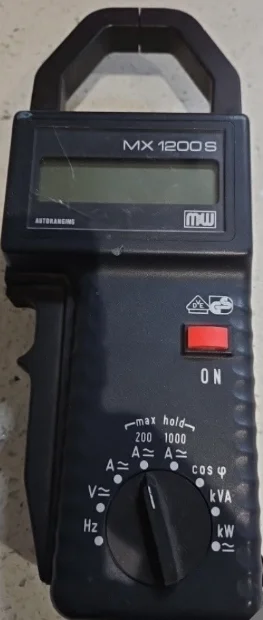

Checking for motor voltage spikes, I assume my Fluke 87V on peak detect should spot them?
Results:
Capacitance (uF):Current U:Current V:Current W:

I’ve bought a secondhand meter capable of measuring power factor. It should arrive in the next few days. I wasn’t aware you could get small meters capable of this. Very cheap at about £25, but seems to be good quality.
Manual here:
https://elektrotanya.com/itt_mx220_mx1220_power_clamp_meter_owners_manual.pdf/download.html
Handheld MW MX 1200S clamp meter with a large jaw on top, an LCD display, a red ON button, and a rotary dial with settings for A, V, Hz, cos φ, kVA and kW.
Although it has only two voltage ports, there is a three-phase adaptor available. Talking to someone who owns one, it’s apparently just two 1 Meg resistors arranged to form a star with the internal resistance of the meter.
Hopefully, I’ll soon be able to test the effect of the PF correction and report back. In the meantime, I was wondering if, due to the imbalanced nature of the rotary’s output, I’d have to test all three phases for PF, and take an average, for both the uncorrected and corrected states?
