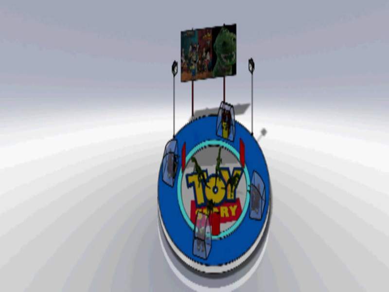

The following picture is a ride that i have design. the outer and the inner layers spin in the same direction and the middle layer spin in the opposite direction. how can i spin the outer layer of the ride and the middle layer of the ride? where can i place the driver?
If i were to use a planetary gear that is very big is it possible? Is there anyway to supend the gears in mid air and let it rotate?
  • Rendered 3D model of a circular carnival ride with a blue rotating platform labelled Toy Story, with six small cabins on its rim and a screen mounted above on two posts.
