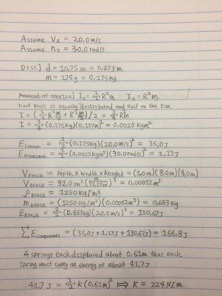

I plan to run a few calculations later. I am going to use initial linear velocity of 20.0 m/s and rotation of 30.0 rad/s which I think are both reasonable goals. The first issue is I cannot seem to find the moment of inertia for a standard disc golf. I don't think it is close enough to a standard disc to use the associated equation and I cannot seem to even find its mass distribution so I am not sure how to proceed from here. Anyone got any ideas or resources? I need the moment of inertia to calculate the total energy transferred to the disc by the device.
After looking for a while I found a mass distribution of half uniform and half on the edge which may or may not be correctly. Anyway, using this along with a mass of 0.175g and radius of 0.137m gave a moment of inertia of 0.0025kgm^2 which I also saw posted somewhere probably using the same distrubution as me. If this is incorrect please correct me someone, thanks.

Also here is some preliminary work I have done. I am sure it is riddled with errors and probably far off from any real values but I managed to determine that the spring constant should be might be around 224 N/m which seems pretty high.
I think it's coming out high because your launcher arm looks like it weighs 4 times the Frisbee's weight. Can you work on lightning the launcher arm? Do you have any sketches of your current launcher design?
