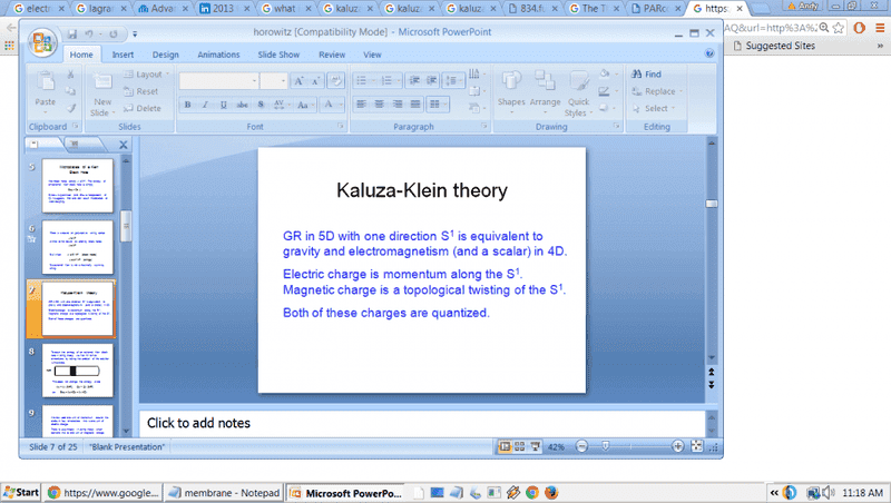

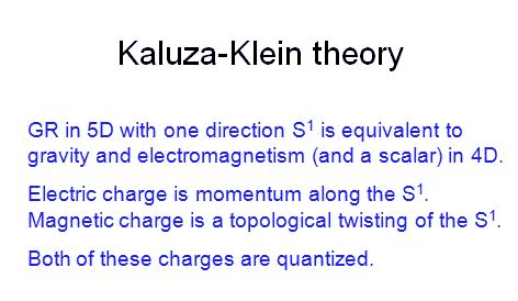

So if you can believe Professor Gary Horowitz the answer is yes and the geometrical picture is,
Slide titled "Kaluza-Klein theory" in blue text: GR in 5D with one direction S1 is equivalent to gravity and electromagnetism (and a scalar) in 4D. Electric charge is momentum along the S1. Magnetic charge is a topological twisting of the S1. Both of these charges are quantized.

Not sure what topological twisting of S^1 means?

  • PowerPoint slide titled Kaluza-Klein theory: GR in 5D with one direction S1 is equivalent to gravity and electromagnetism (and a scalar) in 4D. Electric charge is momentum along the S1. Magnetic charge is a topological twisting of the S1. Both of these charges are quantized.
