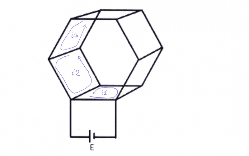

Why is Kirchhoff's voltage law (KVL) of no use?
You can setup 7 equations as for 7 loops ( 6 loops in the hexagonal itself and one loop including the battery). The current flowing through the battery is simply the loop-current through the battery.
That will make it too complicated.I mean there must be a simpler way! This problem was a 3 min MCQ question in my institute's previous year's question paper!
Well, you said that KVL is of no use, but that is not true: It is complicated.
Set R = 1Ω, calculate the current, then divide the result by 6. It then takes no time to setup the equations. But of course you spend some time to enter the equations in your calculator.
Maybe you can find some electrical symmetry in the circuit and cut it into pieces, but if you spend 10min to do so, I will have solved the problem before you with KVL. :smile:
Well ok,but how are you taking the potentials of the nodes?
I'm having problem in framing the equations P :-(!
At first a suggestion: What will happen if you move the connections to the battery a ½R into the paper? ( middle of the ribs ). Then there is some symmetry.

You must draw the 7 loops with positive direction of circulation. Call the loop-currents i1 . . i7. Now follow exactly what kirchhoff states.
In the KVL, you must substitute ΔV by R*I. In this way you will find the currents ( not the voltages ).
Give it a try. Post your drawing and just one of the equations.

You are not drawing current-loops, but nodes.
Drawing (only 3 loops ):
Equation as for i2:
-4*R*i2 + R*i3 + R*i1 = 0 , R = 1 =>
-4*i2 + i3 + i1 = 0
Now, try with other 6 loops.
How did you write the equation for the loop involving the cell ?I got the rest of the 6 equations but I guess my cell equation is wrong!
@Hesch
You follow the arrow for i2: You will cross 4 resistors looping around, with the value R. therefore i2 results in a voltage drop = -4*R*i2.
One of the resistors in the loop is crossed by the current i3 in opposite direction, which yield a voltage rise = R*i3.
One other resistors is crossed by the current i1 in opposite direction, which yield a voltage rise = R*i1.
The sum of all these voltage changes must be zero, thus:
-4*R*i2 + R*i3 + R*i1 = 0.
Setting R = 1Ω, this can be rewritten:
-4*i2 + i3 + i1 = 0
Be very careful with the signs. ( That's why you have to make a drawing, so that you know what you are doing ). Having calculated the currents, remember to divide their values by 6, as the real value for R is 6Ω ( not 1Ω ).

@Hesch I got the 6 equations as follows:
i2+i6=4*i1
i3+i1=4*i2
i2+i4=4*i3
i3+i5=4*i4
i4+i6=4*i5
i1+i5=4*i6
Then,the solution of these six equations is i1=i2=i3=i4=i5=i6=0 !
All the currents in all loops is coming as 0!
What does that mean??
Of course it will give 0: You have not connected the battery! One more loop including the battery is needed.

How do i write the 7 th equation involving the battery?
@Hesch
With a clockwise loop:
i1 - i7 = -11V
Remember to include i7 in the loop for i1.

I'm getting current in cell as (15.46875/6)=2.57 (approx) am I right?
Well, 2.578125A ≈ 2.58A
So an important conclusion is: You can find currents with KVL, and you can find voltages by KCL.
