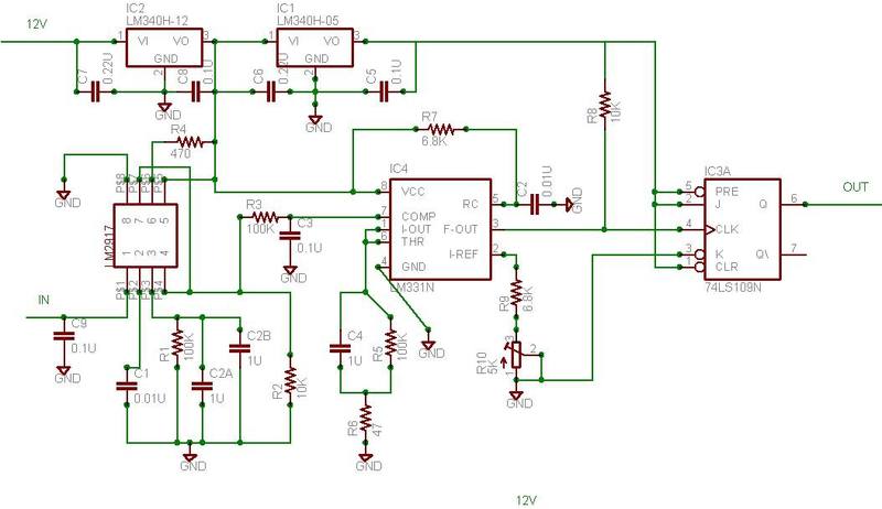

Hey all,
Im working on making a signal converter for a mod I've done on my car,
the plans for it are from zilvia.net - 164351-s15-cluster-sig-converter (edit: link was not working and apparently triggered spam detector)
yet I've been looking around a lot of places and can't find the lm340H-5 and lm340H-12 (or the lm140 it says could be used instead)
I have however found a place i can get lm340T-5 and lm340T-12
what I am wondering is can i use those regulators instead of the ones the schematics asks for?
thanks
Scott

IC1 and IC2 are the volatge regulators. IC2, C7 and C8 regulate the input voltage
to 12v which is used for power to the LM2917 and LM331. IC1,C6 and C5 then regulate
that to 5v for logic high and power for the 74LS109N.

The H and T are probably different styles of packages for the same electronic device.
H is probably a TO39, round package with 3 pins from the base. T is probably a flat T0220 package designed for bolting onto a heatsink.
Since your circuit seems to be very low power, you probably don't need a heatsink anyway so it doesn't matter which you use, but if you have a circuit board, it will be designed to take one or the other, and the T package is bigger than the H.
FWIW the commonest parts used now for these regulators are the 7805 and 7812 which you can get anywhere - unless there some reason why you really need the 340 parts for this circuit.

chip lm2917 i have one and its a 14 pin chip, the one the person who made the above used was a 8 pin chip, if i use the 14 pin chip do i still just use the same pin numbers or will it be a different layout ?
thanks again
edit: looking at the data sheets i need to bridge pin 11 and 12, then bridge pin 3 and 4, and then i should pretty much have the same chip and just use the data sheet to see what pins do what?
That looks about right. Figures 2 and 4 on http://www.ti.com/lit/ds/symlink/lm2917-n.pdf
