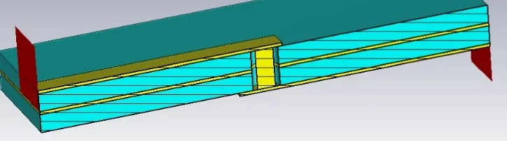

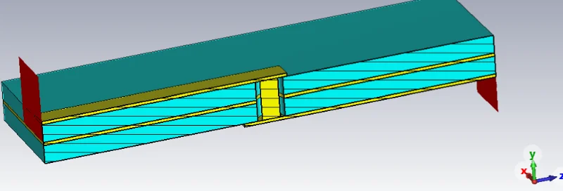

Hello ,I have simulated a basic VIA (shown in the photo) in CST EM simulator from 0 to 40GHz and extracted its attached S2P.
using the code below I resampled it and made IFFT with multiplied the normalised hamming window.
I got the following plots in MATLAB.
Is there a way to interpret the VIA properties threw these TRT and TDR plots?
Thanks.

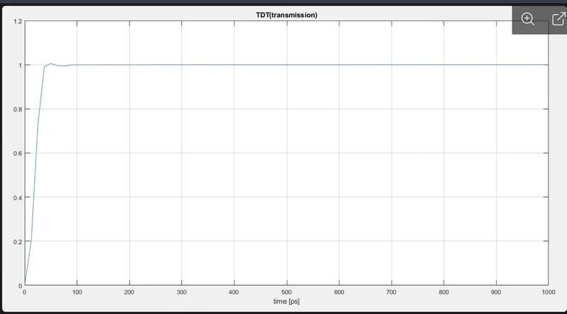

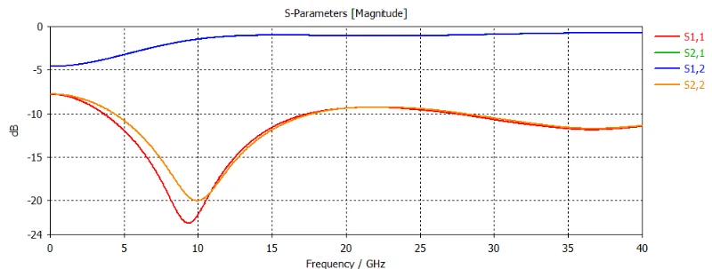

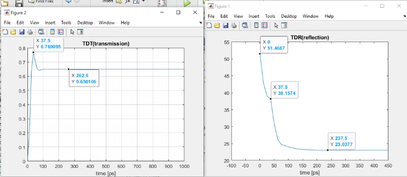

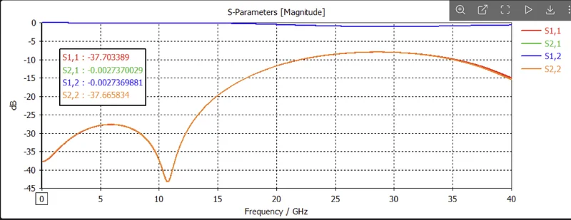

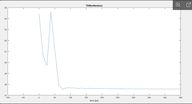

Hello , I have resimulated the structure in another way and got a result much better to realistic DC value
s-parameters .
I made again IFFT to the S2p file and got the attached plots.
given my situation few questions:
1.given my 40GHz BW what kind of sizes I can use TDR TRT effectively
2.given my new IFFT plots is how can I see the geometrical properties of the VIA in them?
Is there some intuitions?

You have two tracks with known impedance, joined through the PCB by a short cylindrical via. The via will probably not match the impedance of the tracks, so it will appear to be a quarter wave transformer with the via length, adjusted for velocity factor √Er.
Usually, only ground and power are routed through vias, and then through multiple parallel vias. It is not good practice to run signals through vias, at microwave frequencies. Keep signals in the signal plane, between or above ground plane(s).
My guess is that the via will appear to be a short cylindrical transmission line, probably inductive. You should be able to see the length of the via in the wavelength of the highest transmission frequency, and the impedance of the via in the TDR. Thinner vias are more inductive, so you may be able to adjust the via diameter until it matches the track impedance on both sides of the PCB. Feathering the track as it approaches the via, may ease reflection from the transition. To get a first approximation, compute the impedance of the via as a longer cylindrical transmission line.
3D render of a stacked multilayer PCB cross-section with teal copper planes, cyan dielectric layers, yellow traces and a yellow vertical via with red side walls at each end.
What you show is a 3-layer PCB, which is not used in practice.

Hello, My goal is to learn to read TDT TRT and to see as much as possible about a VIA.
this imaginary PCB simulation is only an example for me to learn via responce in TDR.
later I will build multilayer VIA PCB.
few questions:
can I see threw tdr tdt responces peaks if its inductive or capacitative peak?
Is there mathematics explaining this?
can I see VIA structure properties threw the peaks of the TDT and TDR?
Thanks.

The "TD" in TDR refers to the time domain (Time Domain Reflectometer). It measures reflections in the time domain as seen at the transmitting port.
Hello , Yes I know what TDR is I need to know how to interpret its capacitance inductance. parts.
how do i do that?
The direction of the reflection (adding or subtracting from the transmitted pulse) will tell you if the ##Z_0## mismatch at the via is positive or negative. From that you can probably infer whether it is inductive or capacitive. Most likely the ##Z_0## mismatch of the via will look positive/inductive in nature.

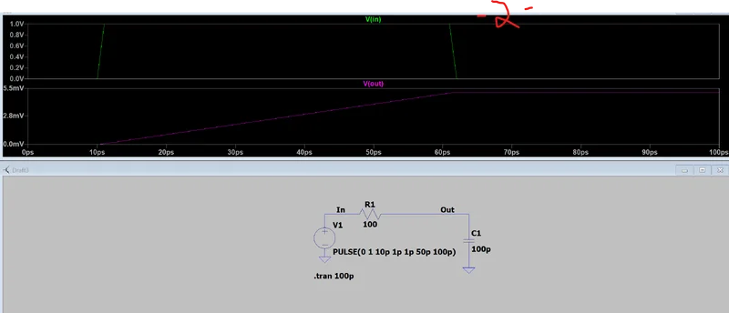

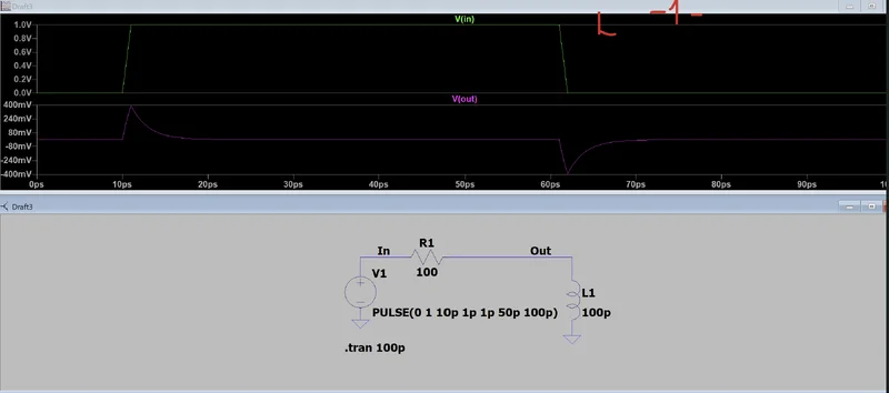

I am trying to simulate time domain reflectometry and recognise threw the pulse responce if the load is capacitative or inductive.
As you can see its not working .
Where did I go wrong with the concept.
what is the proper way to see threw the time responce if the load is capacitative or inductive?

TDR is a plot of impedance (driver voltage) against reflection time.
Z = √( L / C )
You cannot say if it is the inductance or the capacitance of the transmission line that has changed, only that the ratio and resulting impedance has changed.

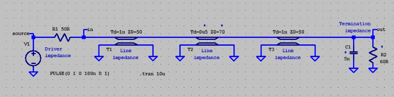

Here is a simple TDR simulated in LTspice.
Remove the .txt extensions from both files, then run the LTspice file.asc
Start by changing the termination impedance and notice how the Vin changes later due to the reflection.
This LTspice model is sufficient to model the signal passing through a via.
T1 is the line on one side of the PCB. T2 will become the via, if it is shortened. T3 is the line on the opposite side of the PCB. Values that are unusual are marked with an asterisk, so they will not be missed or forgotten.

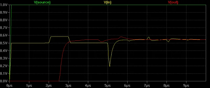

LTspice schematic of a transmission-line chain: a 50R driver resistor R1 and pulse source V1 feed T1 (Td=1u, Z0=50), T2 (Td=0u5, Z0=70), and T3 (Td=1u, Z0=50), ending at a 5n capacitor C1 and a 60R load R2 labelled termination impedance.
This is the TDR response due to the T2 (via) impedance and the capacitive termination.
LTspice simulation plot of TDR waveforms: green V(source) steps to 1.0V near 0 µs, yellow V(in) rests at 0.5V with a downward pulse near 5 µs, red V(out) rises from 0V near 2.5 µs and settles near 0.55V.
The green shows the driver pulse, the yellow the TD reflected signal, and the red the destination signal. TDR times are twice the transit times.
Notice how T2, the higher impedance line, shows as a higher voltage.
Notice how the capacitive load shows as a downward pulse, series inductance would make a positive pulse.
Notice the final output voltage settles to slightly greater than 0.5V, because the termination resistance is greater than 50R.
Following the capacitive pulse in the TDR, are secondary echos of the capacitive pulse in both end mismatches of T2, first positive, then negative. Change Zo of T2 to say 40R, so the T2 voltage will step down, and see those two echos invert.
This model shows how TDR can look down a line at impedance discontinuities, and how the reflection can be interpreted. That will give you an understanding of TDR. To model a real via using this schematic, you will need to significantly shorten the length of T2, and greatly reduce the rise time of the test pulse. Short TLs, and fast rise-times, will slow down the simulation.

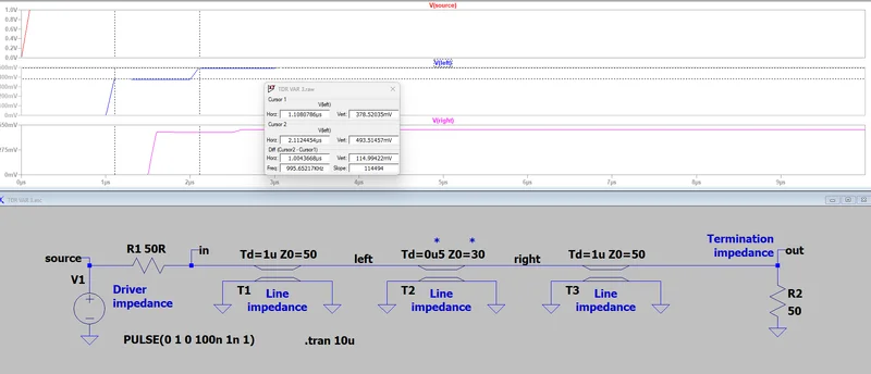

Hello Baluncore,regarding this good simulation, few questions:
1.The most important is,How do you see that the echo from the right side and the left side of the T2?
How do you distinguish between them and spot the source of the discontinuety purely from a ripple in the time domain? could you please give some graphical or mathematical intuition?
"Following the capacitive pulse in the TDR, are secondary echos of the capacitive pulse in both end mismatches of T2, first positive, then negative. Change Zo of T2 to say 40R, so the T2 voltage will step down, and see those two echos invert."
2. why did you terminate with 60Ohm in parralel with 5nF.
3.I know that phase velicity*round_trip_time*0.5 is the distance.we dont have phase velocity.
so If I want to locate my via in the PCB ,how do I convert this ltspice time delay into distance?
I think I should answer your questions backwards.
yefj said:
3. I know that phase velicity*round_trip_time*0.5 is the distance. we dont have phase velocity. so If I want to locate my via in the PCB ,how do I convert this ltspice time delay into distance?
LTspice models the specified circuit parameters against time. It does not model physical dimensions, so for LTspice transmission line models, you must specify the time delay. The physical length and the velocity factor are irrelevant to LTspice.
Knowing the velocity factor vf, and the speed of light c = 299 792 458 ;
Time = Length / ( vf * c ) ;
Length = Time / ( vf * c ) ;
Where time is in seconds, and length is in metres.
Because it demonstrates the negative kick of a capacitor, and how the final termination impedance of the line controls the final voltage in the TDR. You need to play with the parameters to see what changes.
That is not "ripple in the time domain", it is the "sum of all echos", from all mismatches, many times. As the pulse reaches each discontinuity, it is split into two, being reflected backwards by the reflection coefficient, and passed forward by the transmission coefficient. Both those signals are then reflected and transmitted, making two more pulses each time they encounter a mismatch. It is that binary tree of split signals, going all possible ways, that makes the network look like a hall of mirrors. If the line is not specified as lossy, the energy in the line will be gradually be lost in the far line termination, or the source impedance of the generator.
The negative kick from the capacitor is a pulse that travels back to the viewer via the echo chamber of all the mismatches between all the lines. You need to experiment with the parameters to understand the implications, and see the patterns.
In our universe we only see reflections from mismatches of impedance. We cannot see the inside of a glass prism, or of a lossless transmission line.

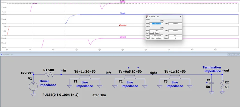

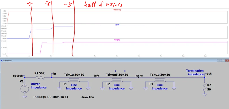

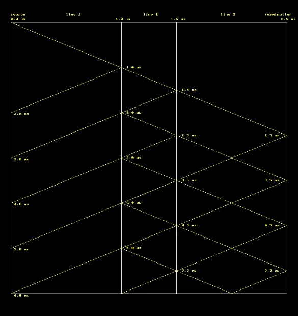

Hello Baluncore ,regarding your good explanantions Two questions:
1. I have made the three transmission line 50Ohms and kept the capacitative mismatch as shown in the photo below.Two questions:
Why on the "out" node there is no negative kick unlike "left" and "right" nodes?
2.regarding the "hall of mirrors", I made a situation where I matched the load and done mismatch in T2 as shown in the second photo.
I know that At first "left" node sees a pulse then the second rise is because a while its a round trip of 30-50 impedance mismatch. the round trip is 1u so the distance is 0.5u as defined in the T2.So I can handle understanding one reflection
When I intreduce the load mistach and I will have double mismatch and there will be a binary tree of reflections.
How can I analyse the time domain plot and see the binary tree reflecrtion structure.
Is there a basic graphical example so I can see the logic of lookind at the pulse and see its "origins"?

LTspice schematic of a 50 ohm transmission line chain: source V1 with R1 50R driver, lines T1 and T2 (Td=0u5 Z0=50) and T3, capacitor C1 5n and R2 60 at the out node, plus simulation waveforms of V(in), V(out), V(source) and V(right) over time.
LTspice simulation schematic: source V1 with pulse through R1 50R driver, then lines T1, T2 (Z0=30) and T3 (Z0=50) to termination R2 50, with probe traces above showing V(source), V(left) and V(right) over 10 us.
LTspice schematic and simulation of a 50 ohm transmission line chain: source V1 with R1 50R driver, lines T1 and T3 at Z0=50, middle line T2 at Z0=30, load R2 50, with waveforms of source, left, and right nodes plotted above.
The network is drawn across the top. The TDR plot is down the LHS, showing how multiple transmissions and reflections sum.
Bounce (lattice) diagram of a transmission line with source, line 1, line 2, line 3 and termination columns, with time labels in microseconds from 0.0 to 6.0 us tracing repeated reflections.

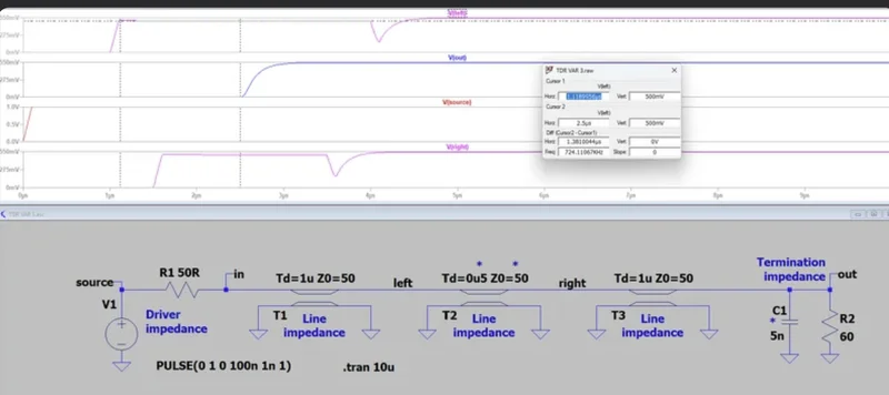

Hello Baluncore,I have made the three transmission line 50Ohms and kept the capacitative mismatch as shown in the photo below.
Why on the "out" node there is no negative kick unlike "left" and "right" nodes?"
Thanks.
When the three TLs have the same impedance they look like a single line. Although you can plot V(left) and V(right), there can be no reflection at those nodes because they are matched.
At V(left) and V(right) you are watching the step move towards the termination, then later, the reflection heading back towards the source. V(out) is the sum of both the incident signal, and its reflection, at the capacitor, with no separation in time or direction.
