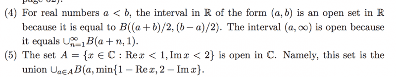

Can someone explain these two examples of an open set

Screenshot below
-Thanks
  • Typeset text listing two examples of open sets: (4) for real a < b, the interval (a, b) equals B((a+b)/2, (b-a)/2), and (a, inf) equals the union of B(a+n, 1) over n; (5) the set A = {x in C : Re x < 1, Im x < 2} is the union of B(a, min{1 - Re x, 2 - Im x}) over a in A.

4) Apparently they have already proven that the open ball in R is an open set. That may be their original definition of an open set. They have also proven that any union of open sets is open. So all they need to do is to rewrite the original set of 4) as the union of balls.
5) Same logic as in 4) except that the balls are in the complex plane, C.
Essentially a set U is open if for every x in U there is an open set ( possibly an open ball) S so that x is an element of S and S is fully contained in U . Can you take it from there @Austin Chang ?
