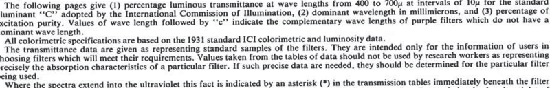

Trying to understand the meaning of "luminous transmittance" as a function of wavelength for standard illuminant "C".
I have a table of wavelengths and percentage values. Can someone explain this statement:
"The following pages give percentage luminous transmittance at wavelengths 500 to 700 nm. for the standard Illuminant "C" adopted by the CIE."
What I need is the ratio of the energy coming out of the filter JF(w) to the energy going into the filter J(w) as a function of wavelength w, which has nothing to do with the response of the human eye and the luminous efficiency function V(w). If I have a wavelength of 450 nm followed by 78%, what does that 78% mean?

Hmm. If they quote the transmittance as a percentage at each wavelength then I don't see what more needs to be said about the filter. The percentages would apply to any wavelength and that would be sufficient for objective measurements. If you have just dived into an article then you may have missed their reason for the statement. If you are already across Colourimetry and colour reproduction etc. etc. then what `i'm saying may be bloomin' obvious. Look at this link (there are better sources, of course) for some ideas about colourimetry.
Now, the transmittance values are probably being quoted in the context of colourimetry and colours perceived by the (average) eye are subjective. The dark line with the dots on it in the middle of the coloured CIE chart represent the colour coordinates for several illuminants. I think that Colour Balance may be where they're heading. If you look at a coloured surface, illuminated by a particular source (illuminant C is one of several standard illuminants) and then under a different source, the subjective effect is to change all the colours of objects.
So basically, adding a filter to the illuminant will change where the colours of objects. In particular, they mention the non-spectral colours (purples etc) which are very much affected by the illuminant.

Hi sophiecentaur - thank you for your response, but I still need a precise explanation of what that "78%" means when the table says "540 nm, 78%". If I shine a 540 nm monochromatic light beam of *radiant* intensity J thru the filter, will the emitted beam have a radiant intensity of 0.78 J ? By radiant intensity I mean physics energy, proportional to h-nu times the number of photons per second. If so, why talk about "luminous transmittance", and "CIE Illuminant C"? When I see luminous, lumens, etc, it means to me that it involves somehow the response of the human eye. For example, luminous intensity at w is radiant intensity at w times the luminous efficiency function V(w) which is the ratio of the eye's *perceived* intensity of a beam at wavelength w divided by the maximum perceived intensity of a beam with equal radiant intensity, which occurs at about 550 nm. I believe that the "total luminous transmittance" of a filter is the integral over wavelength of outgoing luminous intensity divided by incoming radiant intensity, but then there is no wavelength dependence. I don't understand what "luminous transmittance" vs wavelength means, nor why the "illuminant C" needs to be mentioned, despite some time spent trying to tie it down.

I think that's the right idea - except that it's not Energy (J or equivalent) but Power (W or equivalent). From what I have read recently, the the luminous transmittance is used for transparent materials and represents the total light transmitted through, less absorption and scattering; a very practical measure. (Try to forget about hν in this context. Photons do very little to help understanding in these classical problems; stick with Power or sometimes Power per unit Area.
You are right about how light flux / lumen defined. 'They' talk about "amount of light" rather than Power and are slppery about how to get from one to the other. As you say, there is an implied factor of the eye's spectral response to do a convertion and, to be precise, the spectrum of the illuminant has to be relevant too. Most of what I find is for consumers to choose the right light bulb!! Not much use here.

Yes, "white" is a very flexible term. I used to work at a lamp factory, and they had a filter whose transmittance closely matched V(λ), the luminous efficiency function for the human eye. Then they just integrated the radiant power out of the filter over λ to get lumens.
Also, I found some old Kodak publications listing Wratten filter transmittance vs λ in percent, and they very clearly state that it is (radiant intensity out)/(radiant intensity in). I guess you could call that "spectral radiant transmittance". These transmittances are similar to the ones in the reference I showed you, in the sense that they don't invariably go to zero outside the 400-700 wavelength interval, like V(λ) does. So I am coming to believe the example of 78% does mean spectral radiant transmittance. Maybe the "luminous transmittance" is a common but unfortunate misuse of terminology, and the reference to Illuminant C is just an irrelevant side note on the illuminant used to make the measurements.
