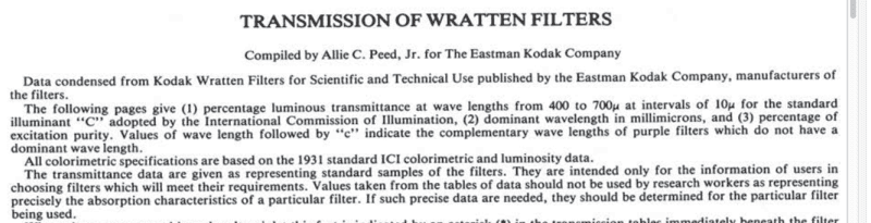

Thank you everybody for your input, but I still am a bit puzzled by the original problem. I'm trying to find out the meaning of "luminous transmittance" at a particular wavelength when characterizing an optical filter. Here's the quote:
I thought we'sorted this out. It's just the percentage of light that gets through at a particular wavelength.
All the rest of that paragraph refers to a particular situation when they use it. For a single peaked filter they seem to reference the throughput at any wavelength to the peak level. For two peaked filters (complementary range of colours like purple) there is a problem because there are two maxima. What is written about that is not clear but you may see what they mean by looking at some actual results of some purple filters. It strikes me that they quote Illuminant C because the components of two-peaked filters will be more affected by the peak wavelength of the illuminant as they lie on the upper and lower slopes of the C spectrum.
If it's not relevant to your particular work then I'd recommend not getting too involved; the basic definition is very straightforward. If you are using more than one filter then you need to use one maximum as a reference.
Forgive me, but it's not sorted out in my mind. Can we define "radiant" to mean energy, or power, or power/cm^2/steradian/hz, i.e. NOT involving the the luminous efficiency function for the human eye V(λ). Can we define "spectral" to mean "as a function of wavelenth". So your definition of transmittance as power out/power in at a particular wavelength is the spectral radiant transmittance. It does not depend on the particular illuminant being used to make the measurement and it has nothing to do with V(λ).
Looking at the numbers in the article, they do not seem to reference any peak. 100% is never found in the list of "luminous transmittances".
When I see "luminous", I expect something involving V(λ). So when I see "luminous transmittance as a function of wavelength" and "using Illuminant C", then either:
1) "luminous transmittance" involves V(λ), in which case your statement that it is spectral radiant transmittance is wrong.
2) "luminous transmittance" does not involve V(λ), in which case the statement in the article is misleading and/or wrong and/or nonsense.
3) The article is correct, and I am baffled and confused.
I just need help figuring out which case is true. And thanks for any insight you can give!
Wouldn't 100% represent no filter in place or a filter with zero loss at its maximum? All filter gels have some loss - they are not multicoated as with high quality lenses.

Hi - thanks sophiecentaur -
"Wouldn't 100% represent no filter in place or a filter with zero loss at its maximum? All filter gels have some loss"
Yes, but the suggestion was made that the transmittance was somehow referenced to a maximum, which would mean every filter would have one or more wavelengths registering 100% (of maximum)
"Transmittance is nothing to do with the source or detector. It's the fraction of light that 'gets through'".
Yes, Jout(λ)/Jin(λ) - but then why call it "luminous transmittance"? "luminous" implies that V(λ) is involved, like "luminous intensity" or "total luminous transmittance" which is the integral of Jout(λ) V(λ)/Jin(λ) over all λ.
I have attached an image of the statement in the article that is bothering me. Please let me know if you cannot view it.

The image of the text was copied from the CRC Handbook of Chemistry and Physics, 90th Edition (2009-2010).
What I want to do is to take MacAdam's raw data from 1942 and convert this into the LMS color space, rather than the XYZ color space as MacAdam did. The LMS color space is based on the latest measured response functions of each cone type in the human eye, and is the basis for any theoretical investigation of color discrimination.
I want to do this without all the approximations MacAdam had to make due to the comparatively limited state of computational resources available in 1942, and without the few calculation errors he made. To do this, I need to know the *spectral radiant transmission* of the Kodak Wratten filters that he used. Kodak published this data every few years starting around 1920, with apparently increasing accuracy, clearly stating that it was spectral radiant transmission. They published much less frequently with the advent of digital photography, culminating in the 2009 article above by Allie Peed, an employee of Kodak, but which confused me. I expect it is the most accurate description.
Thanks for your attention to this!
Attached is a larger image of the first page of the 2009 article by Peed:

To be certain what it's all about, you would need details of the experimental setup.
I could suggest that they didn't measure input and output levels at each wavelength but relied on measuring the peak (or something) of the illuminant C spectrum and a 'corrected' value for the filter input for each measured output wavelength. That would give a more accurate measurement for the Wratten Filter characteristics relative to a flat input spectrum.
Hmm - That might be the case. In other words, knowing the SPD of Illuminant C to within an constant, they would only have to measure it at one wavelength to determine that contant, and then could scan the output from the filter to get transmittance.
MacAdam's 1942 paper gives loads of detail on the experimental setup, but states that the Wratten transmittances were measured for each filter, not trusting the published data for any individual filter. He published his measured transmittance data for maybe 15 filters as examples, but there are about 120 filters that he used, so I have to rely on published data to fill in the blanks.
I think I am going to have to compare Peed's data to earlier measurements which I know are intensity out/intensity in, and see if they differ greatly, in which case I will suspect Peed's data.
