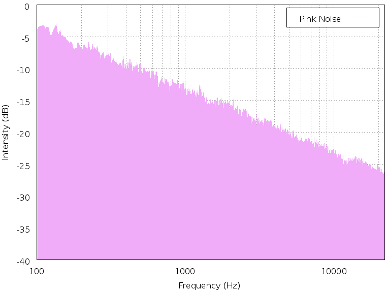

btb4198
570
Can someone go over the pink noise algorithm for ?
I am not really understand how to make pink noise
this is what I did :
Code:
        for (int n = 0; n < sampleCount; n++)
            Frequency_Start = rnd1.Next(8);
            Frequency_End = Frequency_Start * 2;
            octaves = Math.Log(Frequency_End / Frequency_Start);
            float temp = (float)((Amplitude +( octaves * -2) ));
            buffer[n + offset] = temp;
            sample++;
              n2++;
        if (sample >= sampleRate) sample = 0;
        return sampleCount;
but it does not sound right

ok i think I know why my code is not working:
Code:
 Frequency_Start = rnd1.Next(255);
this will alway return the same number...
ok i have been reading this site:
http://hyperphysics.phy-astr.gsu.edu/hbase/audio/equal.html
and this one:
http://en.wikipedia.org/wiki/Octave_(electronics )
so i changed it to this :

Here's a pink noise generator written in java with some explanatory notes:
http://sampo.kapsi.fi/PinkNoise/
With respect to your code, perhaps you'll need to use a debugger to step through each line and make sure the calculations match what you expect. If you have to run many loop iterations then perhaps print statements or logging statements (log4j or log4c depends on what logger is supported for your language).
You could also print the final result as a csv file and then import it into a plotting program or Excel to see how it plots. I don't see anything off the bat that I'd say is a problem and I don't have the programming environment that you are using so in your case you need to debug it and see where it goes wrong.
Lastly, maybe it is a hardware issue where you've generated the data correctly but the hardware just can't play it. If so then there may be comments about the hardware somewhere on the web or vendors site.
Look at the output of the Frequency_End = rnd1.next(255) you have initialized Frequency_End = 4000 and yet it looks like your random number generator will return something from 0 to 255? and the initialized value is never used.
Perhaps your code should say:
Code:
 Frequency_End = rnd1.next(4000)
I did that, and i got a sound for like a sec and then it stops
perhaps you can add prints to see what the sampleCount is inside the Read() method as I don't see how the program calls the Read() method.
would the Voss algorithm work ?
if so can someone explain to me how it works ?
The only way I know to computer-generate pseudo random noise of a specific spectrum is to send a uniform random series of numbers through the correct Tustin transformation. The Tustin transformation will make each output depend on all the previous outputs so that the desired balance of frequencies is obtained. It will accentuate the desired frequency ranges and attenuate the undesired ones. As far as I can tell, that doesn't look like what your code is doing.

ok that does not sound like pink noise is this right ?
Code:
using System;
using System.Collections.Generic;
using System.Linq;
using System.Text;
using NAudio.Wave;

ok,
I change the code some
i have this now:
Code:
using System;
using System.Linq;
using System.Text;
using NAudio.Wave;
using NAudio;
//using System.Numerics;
namespace Isochronic_tones_generator
    class PinkNoise : WaveProvider32
        int max_key;
  int key;
  float [] white_values;
  UInt16 range;
  Random  rnd1 ;
  int sample;
    public PinkNoise(UInt16 range = 128)
        rnd1 = new System.Random();
        white_values = new float[5];
      max_key = 0x1f; // Five bits set
      this.range = range;
      key = 0;
      sample = 0;
      for (int i = 0; i < 5; i++)
 white_values[i] = (rnd1.Next(22) % (range/5));
    public override int Read(float[] buffer, int offset, int sampleCount)
            buffer[n + offset] = (float)( GetNextValue());
            sample++;
        return sample;
     public float GetNextValue()
      int last_key = key;
      float sum;
      key++;
      if (key > max_key)
 key = 0;
      // Exclusive-Or previous value with current value. This gives
      // a list of bits that have changed.
      int diff = last_key ^ key;
      sum = 0;
   // If bit changed get new random number for corresponding
   // white_value
   if ((diff & (1 << i)) != 0)
       white_values[i] = rnd1.Next(22) % (range / 5);
   sum += white_values[i];
      return sum;
it sound more like a ocean .. which it what I think it should sound like.. but starts off low and getting louder which is ok, but it get too loud and my speakers die out.
how should I fix that ?
I am thinking of doing nd1.Next(9)
what do you guys think?
