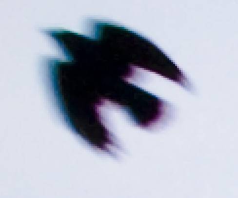

If the sun was off-center in the field of view, chromatic aberration won't be uniform around the circumference.
https://www.galileoscope.org/gs/sites/galileoscope.org.gs/files/Chromatic-Aberration.jpg
Source for moon photo:
https://www.galileoscope.org/gs/content/specifications
