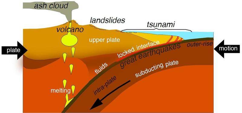

You've got it a bit backward. You want to put the trash into a subduction zone rather than a volcano.
In a subduction zone, it gets carried deep into the Earth, mixes and reacts with what's down there, and doesn't reappear on the surface for a billion years or more.
I can’t put my finger on a source, but I seem to remember this being suggested as a solution for nuclear waste disposal some time back.
Brilliant! So I’m not totally off base here. Just need to figure out how to get it on the plate that is sliding into the earth. My guess is the pressure is so high down there that the gas will stay dissolved in the mantle. Also need to make sure we don’t get back pressure pushing the flaming trash back out.
As @russ_watters said, the main issue with properly maintained landfills in developed countries is NIMBY-ism. Treating the waste and storing it isn't a particularly pressing logistical problem. Plus, the cost of engineering a subduction zone disposal scheme for regular waste would be astronomical compared to current waste management costs.
From the google search that @Bystander provided, I'm gathering that the main objection to storing nuclear waste in a subduction zone is that those areas tend to be earthquake-prone and otherwise geologically unstable. Plus you have to worry about high-pressure salt water corroding whatever container you've put your nuclear waste in.
