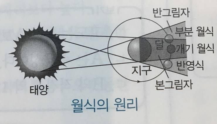

Then, is this picture wrong?
the part of '부분 월식' means 'partial lunar eclipse',
and '개기 월식' means 'total lunar eclipse',
as you said that these 2 things cannot happen at the same time

Why would it be wrong? The Moon cannot be at two places at the same time.

I think that picture wants to show the route of total lunar eclipse.
Yes, and as I said, you need to go via a partial eclipse to get to the total eclipse. However, a partial eclipse can occur without ever reaching a total eclipse.
For purposes of recording or reporting or predicting a celestial event, the definitions of total and partial lunar eclipse are mutually exclusive. By such definition, a partial eclipse is never total, and by terms of experiential reference, a total eclipse can be seen to manifest first as partial, then as total, then back to partial, and only in some locations at one time, in others at other times, and in still others not at all. By celestial definition, a partial eclipse is one that is never total anywhere on Earth. Neither by celestial nor by experiential definitions can a lunar eclipse be both total and partial in the same place at the same time. A good basic exposition regarding lunar eclipses can be found here: https://www.space.com/15689-lunar-eclipses.html

Diagram titled 월식의 원리 (principle of a lunar eclipse) showing the Sun at left, Earth in the centre with its umbra and penumbra shadow cones extending right, and three moon positions labelled 반그림자 (penumbra), 부분 월식 (partial eclipse), 개기 월식 (total eclipse) and 반영식 (penumbral eclipse), with 본그림자 (umbra) labelled.
The illustration is correct (though obviously not to scale), but it doesn't show, or purport to show, partial and total eclipse in the same place at the same time. It can be seen that the labeled indicators reference different parts of the illustration, and those different parts mean either different places at one time, or the same moon in different places at different times, not the moon in both partial and total eclipse in the same place at the same time.
In the illustration, the Sun and the Earth are in a fixed position (relatively), and the moon is illustrated by multiple images, i.e. by the 3 smaller circles along an arc at the right. One of the moon images is in the penumbra shown in the lower part of the illustration, one is in the umbra, shown in the middle part, and one is emerging into the penumbra shown in the upper part.
The reason for there being more than one moon circle is that more than one lunar time and place is being shown. The illustration shows the progression of the moon from penumbra, i.e. partial eclipse, through umbra, i.e. total eclipse, and following that another penumbra, i.e. another partial eclipse.
