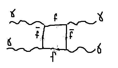

How can photons interact with each other? they don't carry a charge. Except for if you mean radiative corrections, something like the attachment.
However I wasn't able to find how to put the arrows :) [could there be an easier diagram?]
  • Feynman diagram of two photons scattering through a closed fermion loop: wavy photon lines labelled γ on the left and right, with internal fermion lines labelled f and f-bar forming a box.
Yeah, that's the simplest diagram for photon-photon scattering.
You put the arrows in one direction around the loop. The fermions are internal lines and you cannot really talk about them being particles/antiparticles. There are also additional diagrams where the order of the connected external lines are permuted with respect to your diagram.
