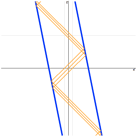

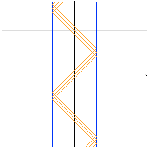

The answer to understanding SR is always Minkowski diagrams.
Here is a Minkowski diagram of a pair of stationary mirrors, marked in blue, with a short light pulse (orange) bouncing between them. The mirrors are unaffected by the light pulse bouncing, implying that this is something like a mirrored box with ends that are joined by springs with a relatively long time constant (i.e., normal matter, with sound speeds ##\ll c##).
There are three orange lines which are meant to represent the paths of three successive wave crests in our light pulse. At the bottom of the diagram the pulse is travelling to the right and bounces almost immediately to the left. The middle of the pulse passes through the origin for our drawing convenience. I've also added three fine grey lines, two vertical and one horizontal. The vertical ones mark the position of the front and rear wave crests at time zero, and the horizontal one marks the time when the center wave crest passes through ##x=0## again, and you can see that the front and rear wave crests pass through the grey line intersections - so the wave has the same wavelength going to the left as it does to the right.
Now let's say you're walking past this at a casual 0.2c. The diagram in this frame looks like this:
This time the blue lines are slanted showing that the mirrors are moving in this frame. I haven't transformed the grey lines - these are new ones, but again they mark the length of the right-going pulse and the return-to-origin time of the left-going pulse. You can see from this that the pulse is shortened when it's travelling to the left. Here's a zoomed in shot of the region:
You can clearly see that the grey lines (length of the right-going pulse) mark out a longer distance than the left-going pulse. So you can see that the pulse is blue shifted compared to the right-going one.
You can also look at the second diagram and see why the left-going pulse takes longer to travel than the right-going one. The left-going pulse is travelling in the same direction as the mirror it will bounce off, so when it gets to where the mirror was the mirror has moved away, so it takes more time than just length-of-the-box-over ##c##. The right-going pulse is travelling in the opposite direction to the mirror it will bounce off, so the mirror covers some of the distance and it takes less time for the light to reach the end than just length-of-the-box-over ##c##. The speed of the pulse is still ##c##, however.
Just a note, the blue lines representing the mirrors are closer together (for example, at the intersection with the x-axis) due to length contraction. Of course, at 0.2c, this will be negligible.
