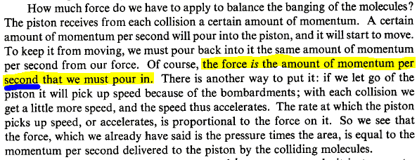

AyoubEd Messages 10 Reaction score 2 Thread starter Jun 28, 2016 #1 can you help me with this, please? Attachments 65.PNG 20.8 KB · Views: 625
CWatters Science Advisor Homework Helper Gold Member Messages 10,546 Reaction score 2,324 Jun 28, 2016 #2 Firstly it doesn't say "one second" it says "per second" which is a rate. Momentum = mass * velocity so Momentum per second would be equal to mass * velocity / time Velocity/time = acceleration. can you do the rest?

NihalRi Messages 134 Reaction score 12 Jun 28, 2016 #3 Force is the change in momentum per unit time. F=ma (m=mass a=acceleration) a= (vf-vi)/t Replacing a into the force equation: F=m (vf-vi)/t Which is change in momentum per unit time.
