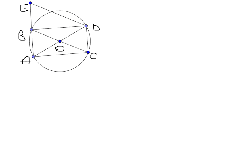

Yes, one more reason to be humble, I know. This is the simplest problem I couldn't solve so far.
Assume we have a circle of center O, a ruler of arbitrary size and a pencil.
We use the ruler and the pencil to choose 4 points on the circle - the extremities of two diametral/diagonal segments.
They build a rectangle. So far so good.
Using the ruler only and the pencil, how can I draw the segment ED (with E the intersection of a line passing through D and the prolongation of AB) which is parallel to the diagonal segment BC?
Thank you for illuminating me.

Is the distance AB something that you can measure with the ruler, such that you can measure off BE to be the same distance as AB? In order for it to be a parallelogram, you will need for BE to be the same distance as DC, which also is the same as AB.
With just an unmarked (?) ruler, all you can do is extending existing lines or drawing new lines through existing points. ABCD has all possible lines drawn already, and extending them outwards does not lead to new intersections that could give new points of relevance. I don't see how you could do anything without a compass or something similar. With a compass it is trivial.

I did not read any of the responses...
I'd say, use a compass. Match the length AB, and mark a small curve distance AB from point B. Now, draw your segment to intersect the small curve. The intersection of the small curve and the "line" you just drew is your point E. NOW connect point E and D using your straight-edge.
This is correct...
1) "Measure" segment AB (or CD).
2) Align the ruler with the segment AB and continue the line through point B until the line you have drawn is equal to your "measurement".
3) Draw a line from D to the end of the line you just drew in step 2.

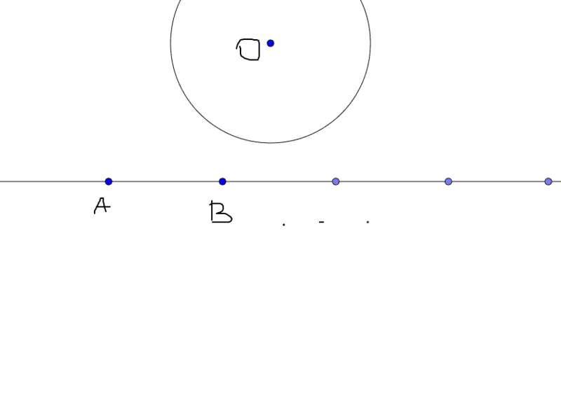

Ok, thank you for your responses. Let me restate my original problem as follows. Using just a circle of arbitrary radius, arbitrary placed center O in the 2D plane, a ruler with no markings on and arbitrary length and a pencil, I must convert a segment AB (i.e. am given A,B and the line between them, again of arbitrary length with respect to the circle's radius and arbitrary placement with respect to the circle's center) into a segment AM 18 times longer than AB and, moreover, the 17 points equally spaced inbetween A and M should be determined (am given only B, the rest of 16, N_1, N_2,..., N_16 should be determined).
Therefore, I need to able to draw parallel lines, 18 of them, using just the given circle and the ruler. See attached.

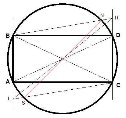

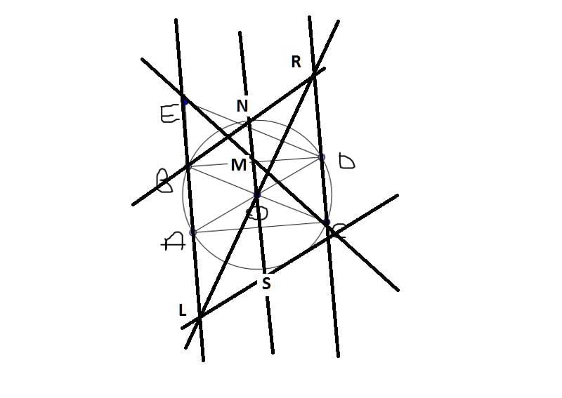

For those with continuing interest in the first problem, here is my solution assuming only unmarked straight edge and pencil.
Draw a new diameter through circle center O such that the diameter projects out of the circle and
- intersects only the extended line projections of sides AB and CD
- does not intersect either rectangle side AB or CD
(So to be clear, for example, the new diameter might project "left" from O down to below A, and "right" from O up to above D.)
Call these new intersections on the line projection of sides AB and CD as L and R.
Draw the lines B to R and C to L (these lines are parallel).
Those lines also intersect the circle (call the intersections N and S)
The line through N O S is parallel to AB and CD.
The line N O S intersects the rectangle side BD at its midpoint, call it M.
A line through C and M intersects line projection of AB at the point E.
Draw line DE.
Why?
Draw the first new line very close to A and D. Then S will be very close to A and N will be very close to D.
There is also a problem earlier, but that can be solved by asking to draw a better line:
They don't have to. Draw the initial line nearly parallel to AB, and the new lines won't intersect the circle.The approach with the new line looks interesting, but so far I don't see how it would help.
Thanks for checking, looks like you are correct. If the midpoint of BD (or any side) can be found then the solution follows; I had tried some different hand drawn tests with rectangles of differing aspect ratio... but not rotated. Noticing angles BNC and BSC will always be right angles... so projecting a new diameter can be used to construct rotated interior rectangles... if only could identify which construction puts NOS parallel to AB and CD.
