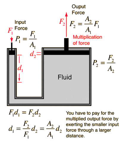

The author describes two principles simultaneously used in any hydraulic brake system, but that are very different: friction and Pascal's.
Please, note that the number 2 in the braking torque means that two forces of opposite directions and similar magnitude F are acting on the disc-pads interphase, regardless the magnitude of the area of that interphase.
That total force acting on the surfaces in close contact induces a resistive force which direction is aligned with the relative sliding and which magnitude is certain percentage of that total force (which we call μ after finding its approximate value via experimentation).
Please, see:
https://en.m.wikipedia.org/wiki/Tribology
If the author was talking about mechanically actuated brakes, like for an old motorcycle, he had no mentioned area at all, but the force with which the pads pressed on the metal surface of the drum.
He talks about area and pressure because he is discussing the hydraulic system that transfers the force and movement of the driver's foot onto the pads.
That combination of force and movement of the brake pedal is mechanical work, which is limited to certain normal amount.
That limited mechanical work becomes pressure and movement of the brake fluid and it comes out at the opposite ends of the system: the pistons of the calipers.
For each caliper, the forces that those pistons are able to apply upon the brake pads, as well as their displacement or linear movement in the caliper, depend on their total area, which depends on individual diameter (respect to the diameter of the master cylinder's plunge) and number of pistons.
Please, see:
https://en.m.wikipedia.org/wiki/Pascal's_law
Hydraulic press diagram: a small input piston with force F1 and area A1 on the left connects through fluid to a larger output piston with force F2 and area A2 on the right, with formulas P1 = F1/A1, P2 = F2/A2, F2 = (A2/A1)F1, F1d1 = F2d2, and d1 = (F2/F1)d2 = (A2/A1)d2.

Brilliant! Fully understood now.
