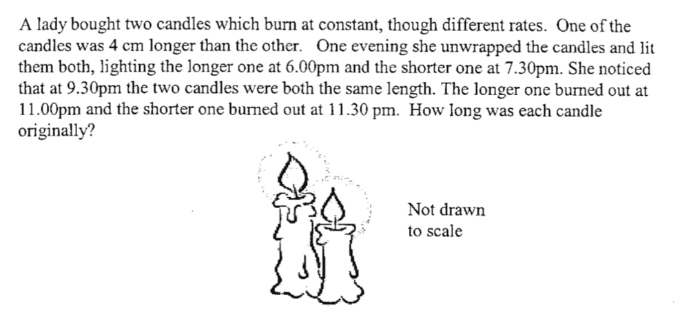

See my answer sheet attached
Please see photos attached for problem and my answers.
Can someone just check my work and tell me if the candle heights I get are correct?

Let "x" be the length of the shorter candle in inches. The longer candle is x+ 4 inches long. Let y be the distance the shorter candle was reduced by in the two hours from 7:30 to 9:30 (at a rate of y/2 inches per hour). The longer candle was reduced by y+4 inches in the three and a half hours from 6:00 to 9:30 (at a rate of (y+4)/3.5 inches per hour).
The longer candle burned out at 11:00, 5 hours after being lit. Since it was shortening at the rate of (y+4)/3.5 inches per hour, we have x+ 4= ((y+4)/3.5)(5)= 10(y+4)/7.
The shorter candle burned out at 11:30, 4 hours after being lit. Since it was shortening at the rate of y/2 inches per hour, we have x= (y/2)(4)= 2y.
Solve the equations x+ 4= 10(y+4)/7 and x= 2y for x and y. The value of x is the answer to this question.

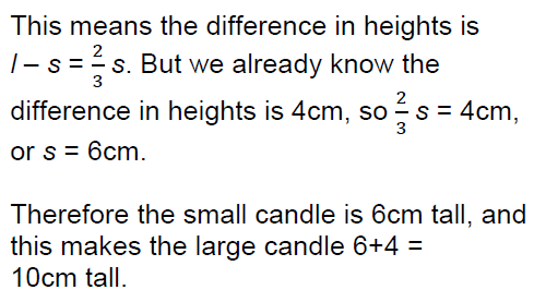

Last portion of your solution:
245650
Your solution is correct.
