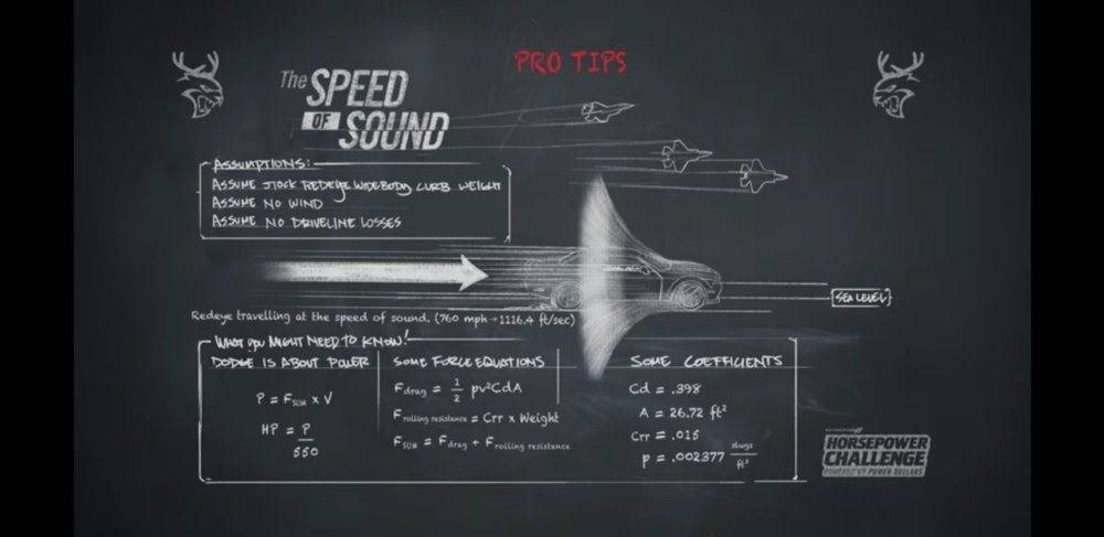

fyithis is next...im coming up with 43,446 HP...i think i might be missing a proper conversion...

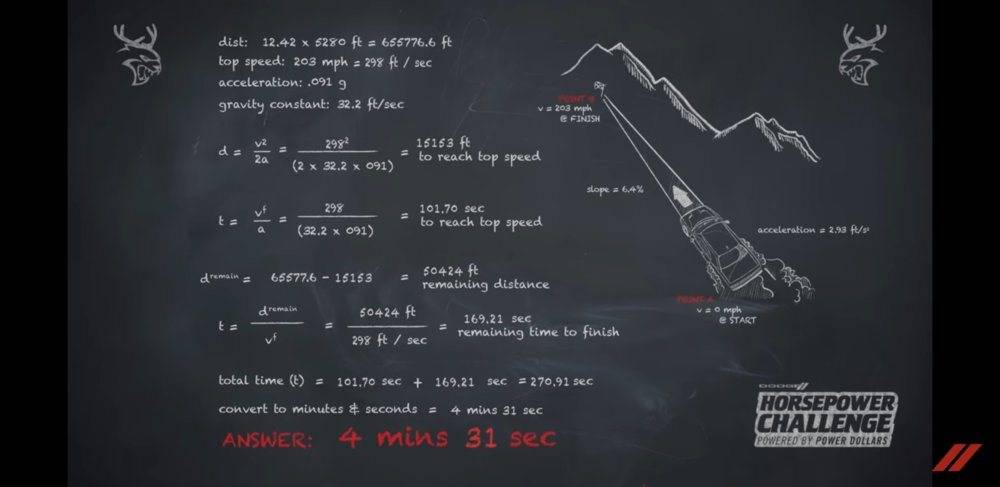

this is the answer to the previous problem

  • #46
So quite easy once it is explained that the straightening of the road was supposed to preserve the length, not the slope - despite that in the question statement the slope is given prominence, while the distance seems to be just background on the actual course.
  • #47
yep..wouldve saved us all a bunch of headaches...
  • #48
Although the 6.4% slope is re-iterated on the solution slide, it is never actually used in the calculation. Despite the prescription of the 0.91 g acceleration being average, the proffered calculation treats it as constant instead.
