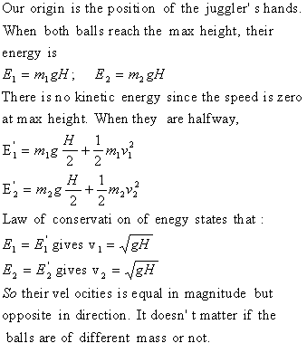

13.) A juggler throws two balls to the same height so that one is at the halfway point going up when the other is at the halfway point coming down. At that point:
a. Their velocities and accelerations are equal.
b. Their velocities are equal but their accelerations are equal and opposite.
c. Their accelerations are equal but their velocities are equal and opposite.
d. Their velocities and accelerations are both equal and opposite.
e. Their velocities are equal to their accelerations.
How do you know that the answer is c?

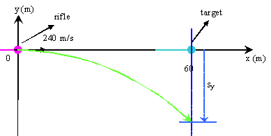

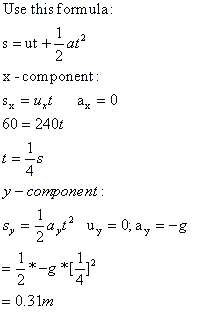

17.) A rifle is aimed horizontally at the center of a large target 60 m away. The initial speed of the bullet is 240 m/s. What is the distance from the center of the target to the point where the bullet strikes the target?
You have 3 vectors that form a triangle and you need to find the third side. 60 is one side and 240 is the other. I found the angle between them to be 75.52. Then I used the law of cosines and found the third side to be 232.379. This is not even close to any of the choices :cry: .
ANSWER: 31 cm.

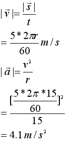

19.) A carnival Ferris wheel has a 15-m radius and completes five turns about its horizontal axis every minute. What is the acceleration of a passenger at his lowest point during the ride?
My Work:
ar= (V^2)/(r)
C= 30pi so v= [(5*30pi)/1 min]
V = 150 m / 60 s
so: ar=.027 :cry:
ANSWER: 4.1 m/s^2

Question #19
v=r*w
[tex]w=\frac{5*2\pi}{60}\ rev/s[/tex]

I think this solution to this problem was completed incorrectly. Here's how it should be done:
Use
[tex]v=circumference/t[/tex]
where t=time
Remember that circumference = 2 x pi x r
r=2.pi.r
t=60/5=12
v=?
Find v using the formula.
Now use this formula to find the acceleration:
[tex]a=v/r[/tex]
where v=average velocity.
You're not finished yet though. You'll need to add this acceleration to gravity (9.8ms) because gravity also acts downwards. So you'll get a + 9.8

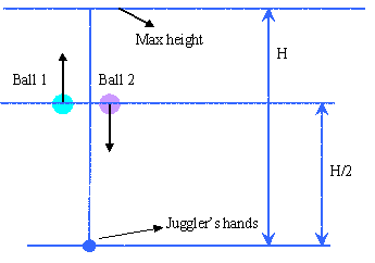

a) Wrong - their accelerations are equal. Gravity is accelerating the one going downwards, and deccelerating the one going up, and gravity is a constant. Since gravity is the only accelerating force acting on them, their acceleration is equal, (9.8m/s^2 downwards.)
However, their velocities are not equal. They are opposite (one is going up, one's going down.)
b) Wrong - See a) Velocities aren't equal, they're equal and opposite
c) Correct - See part a) and b)
d) Wrong - See the above parts
e) Wrong - See the above parts
Make sense?

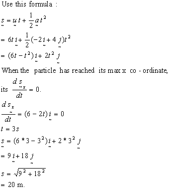

Question 15 said:
15.) A particle starts from the origin at t=0 with a velocity of 6i m/s and moves in the xy plane with a constant acceleration of (-2i + 4j) m/s^2. At the instant the particle achieves its maximum positive x coordinate, how far is it from the origin?
I don't know where to start. I don't understand how you would find this.
ANSWER: 20 m
Don't panic!
Whenever you get a calculation, always write down what you know. It makes everything easier to see.
v(initial)=6i m/s
v(final)=?
a= (-2i + 4j) m/s^2
starts at coordinate (0,0)
need to find max x point
Sorry, I've run out of time. I'll help you some more, when I get home. But try and see where you can go from here. You need to find where x is greatest. Instead of x, think of it as displacement, then use the equations of motion to work out where displacement is greatest. Then you're done!
You have 3 vectors that form a triangle and you need to find the third side. 60 is one side and 240 is the other. I found the angle between them to be 75.52. Then I used the law of cosines and found the third side to be 232.379. This is not even close to any of the choices .
ANSWER: 31 cm.

Question #19
I guess i have to find alternative since Latex has not been working since yesterday. Have a look at the attached file. Forget about the 'w', i don't want to confuse you. just use the circumference given by 2*pi*r.
Question #17 : 2D Projectile Motion
You can't use a right triangle for a projectile motion.
Question #15

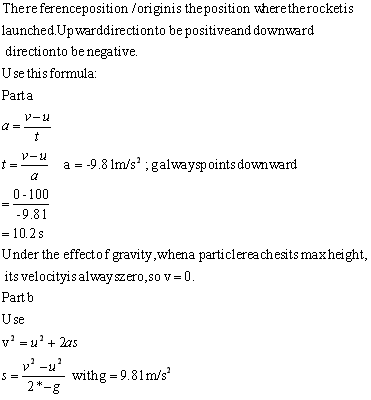

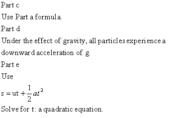

Having problems with this:
(6) A rocket is fired vertically upwards with an initial velocity of 100m/s^2. Calculate:
a. the time for the rocket to reach its greatest hight >answer> 10 seconds
b. the hight to which the rocket rises >answer> 500 meters
c. its velocity after 4.0 seconds >answer> 60 m/s^2
d. the acceleration at the top of the path of the rocket >answer> 9.8 m/s^2
e. when the rocket is 400 meters above the ground. >answer> 5.5 seconds
If anyone could explain how to get these answers, it would be much appreciated. :uhh:
I am getting very confused with the Kinematics Equations.
Thanks again for anyone who can help!
-- doyle_43
Doyle,
Have a look ...
Question #13: Law of Conservation of Energy
The direction of their velocities and the acceleration have been explained clearly by Andy. I explain why their speeds are the same.
