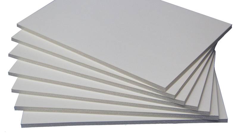

As an ME, you may be using Foam Core material sheets for some of your models and mock-ups in the future. It's a much more stable material than just cardboard...
https://www.superlinkstore.com/assets/uploads/2016/04/whit-paper-foam-core-board-copy.jpg

I have used foam board for many prototypes with low loads. For items thicker than the basic 1/8" board it is best to use the 1/8" board and laminate it to the thickness you require. For substantially stronger pieces, using simple thin plastic sheet laminated on both outside faces of the foam board assembly adds an amazing amount of strength to the structure (I buy the standard plastic sheet signs sold at the local hardware stores in my area for material because this material is very easy to cut). For pivots or bolted connections you need to insert and glue pieces of metal tube through the sheet structure to act as bushings (12" lengths of aluminum or brass ones in various diameters are also available at my local hardware stores).

Just as a note on the cutting of foam board, it can be difficult to get a clean edge cut with this material. First, a very sharp cutting blade is required and the foam interior tends to grab on the faces of a cutting blade and tear, which I have discovered can be remedied by repeated applications of a film of "petroleum jelly" on both faces of the cutting blade (as improbable as this may sound).

I've been reading much more into foam and plastic options (probably going to do a plastic-foam sandwich), but foam core distributors I find tend to be from industrial supply quantities or "craft store" display foam board. Should I search for a particular type of foam or am I reading too deeply into material design for this small of a project?
The foam board I use is straight from the local crafts store. To my knowledge there are no different grades of this material.
