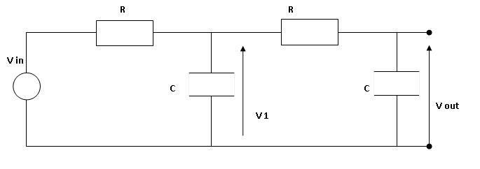

Given the coupled RC network shown below (see attachment), show that the voltage transfer function is
[tex]\frac{Vout}{Vin}=\frac{1}{(1-\omega^2C^2R^2)+3j\omega CR}[/tex]
Hint: [tex]\frac{Vout}{Vin}=\frac{V1}{Vin}\frac{Vout}{V1}[/tex]
For Capacitor, [tex]Z=\frac{1}{j\omega C}[/tex]
General Potential divider equation [tex]Vout=\frac{Z2}{Z1+Z2}Vin[/tex]
I find this all a bit confusing :( I know that the second filter is acting as a load for the first filter, so I know I just can't write
[tex]V1=\frac{1}{j\omega C}\frac{1}{R+\frac{1}{j\omega C}}Vin[/tex]
So would I need to combine the total impedance of the second filter with the impedance of the first capacitor?

Just like to say I finally got it :)
I just used [tex]V=IZ[/tex] really.
Say that current [tex]I[/tex] flows through the first filter and current [tex]I_{1}[/tex] goes through the second one.
Starting from the right, [tex]I_{1}=j\omega C\times V_{out}[/tex]
[tex]RI_{1}=j\omega CR V_{out}[/tex]
[tex]V_{1}=RI_{1}+V_{out}=(j\omega CR+1) V_{out}[/tex]
[tex]RI=R(I_{1}+j\omega C V_{1})=(2j\omega CR-\omega^2 C^2R^2)V_{out}[/tex]
[tex]V_{in}=RI+V_{1}=(1+3j\omega CR-\omega^2 C^2R^2) V_{out}[/tex]
hence original result is obtained.
