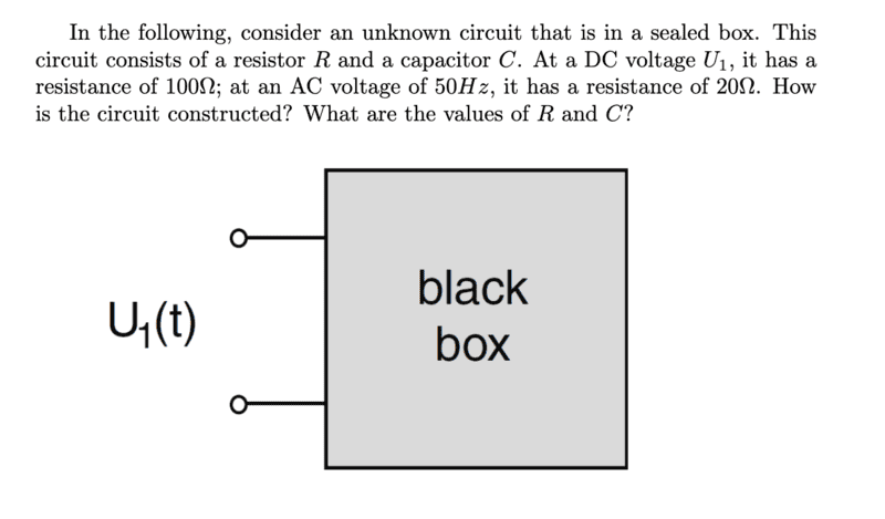

Hi,
I am not sure if I have calculated the task correctly
Text problem asking for the construction and values of R and C in a sealed black-box circuit, with resistance 100 ohms at DC and 20 ohms at 50 Hz, shown beside a box labelled black box with input U1(t).

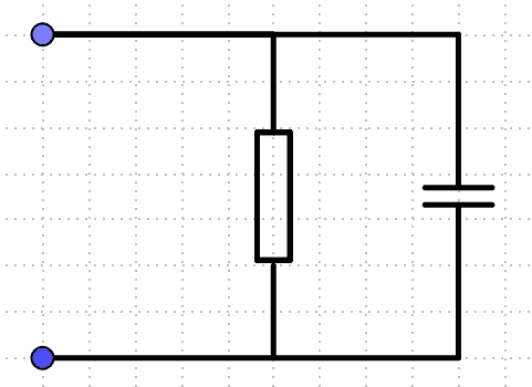

I have now assumed that the capacitor does not need to be charged and is therefore fully charged. In a DC circuit, a capacitor acts like an infinitely large resistor or like an open switch, so I assumed that it is a parallel circuit and that it looks like this.
Circuit schematic of a resistor and capacitor connected in parallel between two terminals, with the resistor drawn as a vertical rectangle and the capacitor as two parallel plates.
The resistor then has the following value ##R=100 \Omega##.
Using the impedance and the value for ##R##, I can then calculate the value for ##C##.
The value for the impedance in parallel circuit is
$$|Z|=\frac{1}{\sqrt{R^-2+\omega^2 C^2}}$$
##C## can then be calculated as follows
$$C=\frac{R^2-Z^2}{R \omega z}$$
If I now substitute all the values into the above formula, I get the following ##C=9.7 \cdot 10^{-4}F##.

It looks like you used frequency, ƒ, rather than angular frequency. Remember, ##\omega=2\pi f ## .

Thanks SammyS for your help and for looking over my calculation, thanks also for the tip on how to write ##R^{-2}## in latex 👍 👍👍
You are right, unfortunately I used the frequency of ##50Hz## in the calculation instead of ##\omega=2 \pi 50Hz##. Then the result for ##C## is as follows, ##C=0.015 F##

The decimal point is in the wrong place.
Simply divide your original answer by ##2\pi## .
