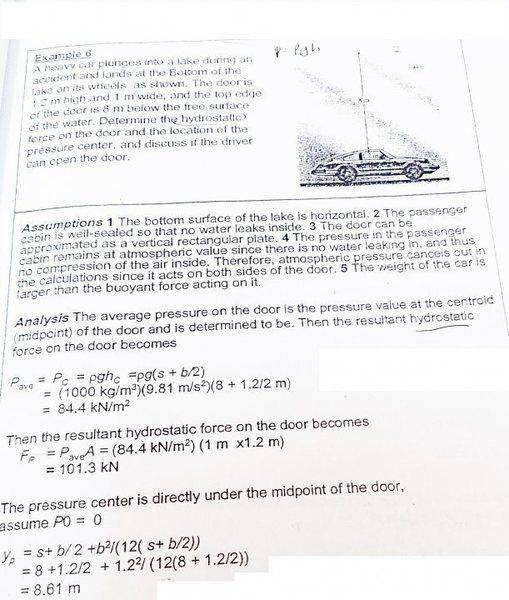

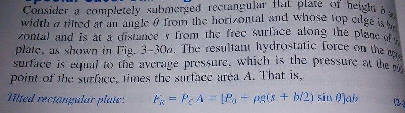

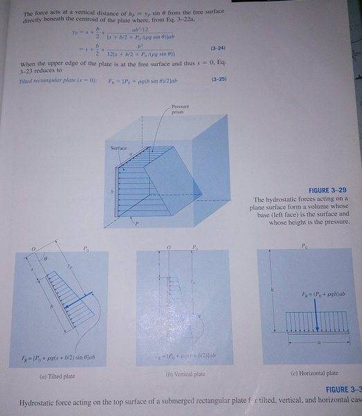

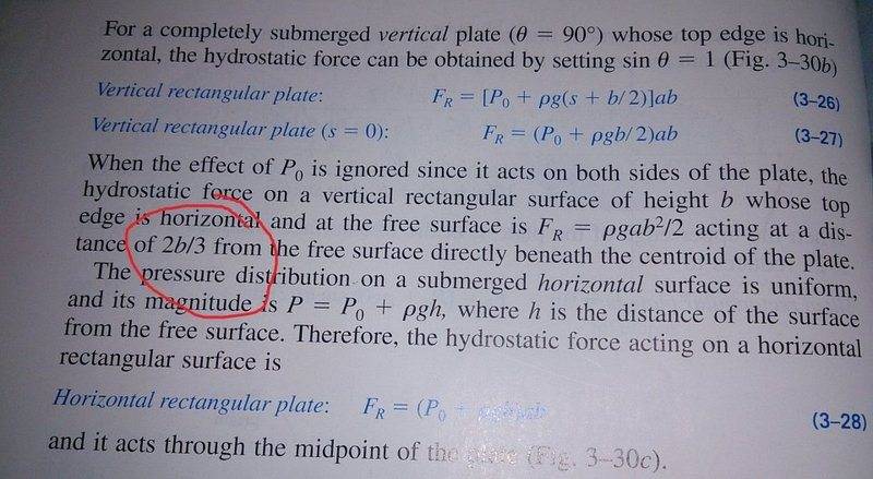

can someone explain about the Fr acting at a distance 2b/3 from free surface firectly beneath the centroid of the surface ?
does the author mean the center if pressure ( point where the FR acts) of the completely submerged plate (90 degree) is at 2b/3 from the top of the surface ? p/s : the whole vertical length of the submerged surface is b
Yes. When the top edge of the plate is at the surface Fr acts at a depth of 2b/3. If the plate sinks further Fr moves towards the centre of the plate (eg towards b/2).

can you explain why in this case , the center of pressure not at 2/3 of the submerged plane ? if it's 2/3 , it should be 8= (1.2/3) = 8.8 m , right ? why the working only showed 8.61m?
It's only at 2/3rds of the height of the plate when the top edge of the plate is at the surface. In the case of the car the top edge is 8m down.
I get the same answer using the equation in your notes...
yp = s + b/2 + b2/(12(s+b/2)
= 8 + 1.2/2 + 1.22/(12(8+b/2)
= 8 + 0.6 + 0.014
= 8.61m
and the equation at the link I posted..
= 2/3 * (y23 - y13)/(y22 - y12)
= 2/3 * (9.23 - 83)/(9.22 - 82)
= 2/3 * (778.69 - 512)/ (84.64 - 64)
= 2/3 * 266.69/20.64
= 8.61m

so, when the top edges of the submerged object is located exactly at the water surface(s=0) , then the center of pressure of submerged object will be at exactly 2/3 of the height of the submerged object ?
Yes. That's mentioned in your image dsc_0525-jpg.
