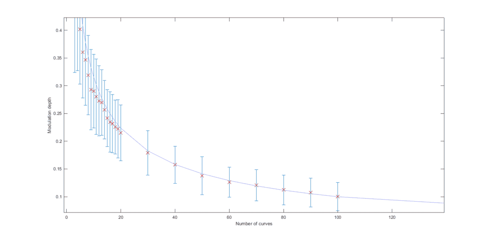

Why does the curve ##1/\sqrt{n}## best fit my simulation data shown below? How does my simulation relate to the Central Limit Theorem?

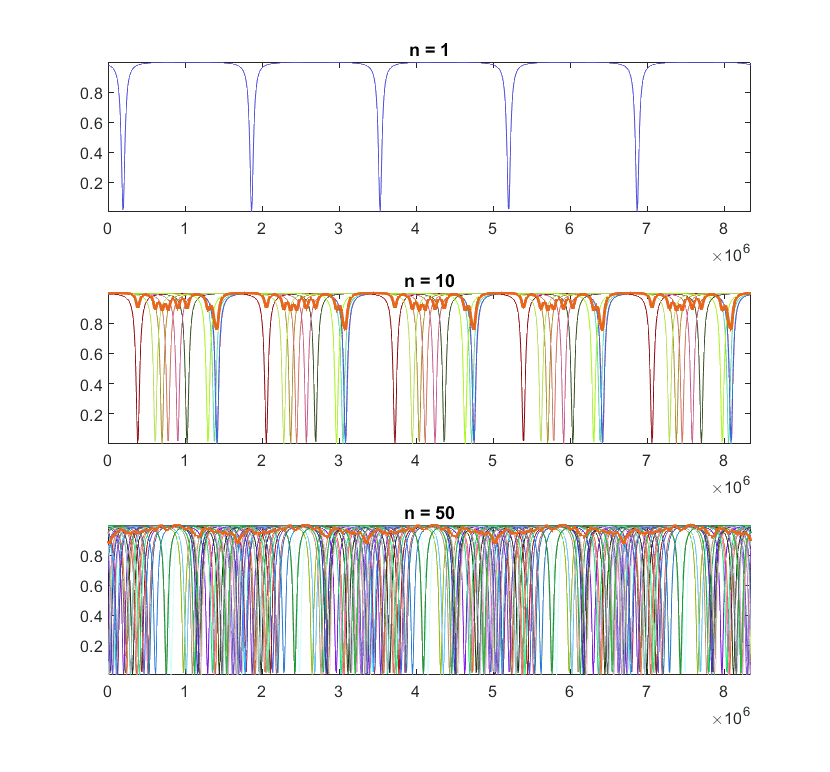

I am working with a simulation which generates an arbitrary number ##n## of identical curves with different phases and calculates their (normalized) sum. As expected, the fluctuation depth of the curves decreases as we increase ##n##. Here is an example of my simulation (when ##n>1##, the thicker line is the final sum):
242530
When I plot the fluctuation depth versus ##n##, I find that they vary according to:
$$\frac{1}{\sqrt{n}} \tag{1}$$
The following are my measurements fitted with ##1/\sqrt{n}##. Each data point is the average of 100 runs and the error bars show the standard deviation.
242531
So, how do we make the connection between my simulation results and the Central Limit Theorem?
It appears that the fluctuation depth is proportional to its standard deviation ##\sigma##. And from the Central Limit Theorem, we know that the standard deviation varies according to ##1/\sqrt{n}##, where ##n## is the sample size.
Any explanations would be greatly appreciated.
What is the definition of "fluctuation depth"?

Yes, I have defined the "fluctuation depth" (or "modulation depth") of a curve ##m## as:
$$\text{modulation depth}=\frac{m_{\text{max}}-m_{\text{min}}}{m_{\text{max}}}.$$

Here is a close up of my data fitted with ##\frac{1}{\sqrt{n}}##. As one can see, the ##\frac{1}{\sqrt{n}}## estimate becomes more accurate as ##n## (the number of underlying curves/samples) is increased:
242975
Is it completely coincidental that the data seem to follow the normal distribution? Or does CLT still apply to some extent?

Let's be specific about what the data is.
I think a red "x" is computed as follows. We fix the number of curves N to be added to produce 1 sample curve. We generate M such sample curves independently. We compute the modulation depth for each sample curve. We take the mean of those modulation depths. This mean value gives us the y-coordinate of the red "x".
The red "x" is the value of the "sample mean" of M independent samples taken from the same distribution The CLT says that the standard deviation of this sample mean (considered as a random variable) is proportional to ##\frac{1}{\sqrt{M}}##. It doesn't say anything (directly) about how the sample mean depends on ##N##.
So the CLT says something about the size of the "error bar" around the red "x". It doesn't say anything about the y-coordinate of the red "x".
One can think of ways to generate "random" curves that would not produce the results in your data. For example, suppose we generate a random curve ##F## on ##[0,1]## by adding ##N## curves, each of which is given by a function whose graph is a straight line from ##(0,0)## to ##(u,1)## and another straight line from ##(u,1)## to ##(1,0)## where ##u## is a random variable uniformly distributed on [0,1].
Such a curve ##F## has a max value of ##N## and a min value of 0. So its modulation depth is ##(N-0)/N##, which is 1, regardless of how big we make ##N##.
It wouldn't surprise me if the CLT can play a role in analyzing your results, but it isn't straightforward to see how. Your results depend on generating the random curves is a specific way.

Thanks. The distinction is clear now. In my experiment, I set ##M## at a fixed value of ##100##.
So, according to CLT we expect the size of the error bars to be proportional to ##\frac{1}{\sqrt{M}}##. But if you look at the plot in my first post, the error bars get smaller as ##N## gets larger. So it appears to me that the standard deviation is clearly related to ##N##. Is there an explanation for this?
The CLT only says that if you are taking ##M## samples from the same random variables then the standard deviation of the sample mean is proportional to ##\frac{1}{\sqrt{M}}##. It doesn't tell us how to compare the standard deviations of the sample means of M=100 samples taken from two different random variables. When you change ##N##, you change the random variable that you are considering.
I think there is an explanation, but the explanation is not given by a simple and straightforward use of the CLT. The explanation must incorporate the particular way that you picking the "random" curves to add. Communication engineers have probably studied the statistics of a signals resulting from adding waves of random phases. Perhaps someone like @Baluncore can tell us their approach to analyzing the problem.

The formula that generates a single curve is:
$$\frac{a^{2}-2ba\cos\varphi+b^{2}}{1+b^{2}a^{2}-2ra\cos\varphi},$$
where the constants ##a,\ b## are fixed throughout the course of the experiment. The only thing that varies is the phase term ##\varphi## given by another equation:
$$\varphi=n c \omega,$$
where ##c## is another fixed constant, ##\omega## are the x-axis points (from a vector), and ##n## is a random number. Numerically, ##n## is made to be in the interval 0.001 away from 1.5 in the positive side.
The algorithm generates an arbitrary number ##N## of these curves by generating ##N## random values of ##n## and substituting them into the equation above. Therefore, each curve is generated by a different ##\varphi## vector, so they each appears to have a slightly different phase/frequency. When ##N>1##, the final curve is calculated by adding all the individual curves point by point.
Do you believe it is because of the way the algorithm was written that the modulation depth varies according to ##1/\sqrt{N}##?

I used the fixed values ##a = b = 0.95##.
##c=3.3 \times 10^{-7}## is also a physical constant that does not change.
I believe the random ##n## is a uniformly distributed random number. In MATLAB this is generated using:
Code:
n = 1.5 + 0.001*rand(1,1)
When I change the parameters ##a, b##, the sharpness of the dips change (in terms of the physics ##a=b##, ##a<b##, and ##a>b## each represent different regimes). However, the modulation depth still obeys the ##1/\sqrt{N}##. Why?
OK, your signal is the same function every time, but the phase is different.
There is no additive phase term in your φ=ncω, so everything is in phase at time ω = zero.
Should that phase not be something more like φ=n+cω.

My simulation relates to optical resonators, where ##\varphi## represents the phase difference imparted by a round trip propagation through the cavity. So, we can assume they all start off in phase, but acquire different phases later on as they propagate.
The actual physical equation that relates phase shift to frequency and ##n## is:
$$\varphi=n \ \omega \frac{ \ \text{Length}}{\text{speed of light in vacuum}} = n \ \omega \ c.$$
From post #1, plots for n=10 and n=50, we see that the phase shift is not distributed linearly over 360°. The maximum of the normalised accumulated signals will be biased closer to 1 than expected because there are some values of w that see very few nearby dips. The minimum will be where more dips are concentrated. Without knowing the actual range and distribution of the phase variation it is not possible to push the analysis any further.
You cover approximately 5 cycles, so you are repeating the simulation arithmetic. It might be simpler and quicker to cover only one cycle.
Since you are summing signals with independent random phase I would expect the CLT to be applicable.
I think that might have been a coincidence. When I run the code many times, often the phase shift is nearly linearly distributed. For instance:
