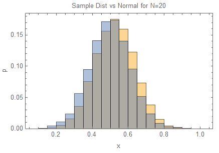

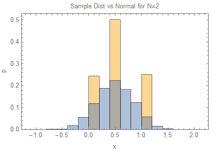

When I run into questions like this, my first approach is to do a quick Monte Carlo simulation and see. Here I used a sampling distribution ##X \sim Bernoulli(0.5)## which has a mean ##\mu=0.5## and a variance ##\sigma^2=0.25##. According to the CVT the sampling distribution of ##\bar X## in the limit of ##N\rightarrow \infty## approaches ##\mathcal N (\mu, \sigma/\sqrt{N})##.
I did a quick Monte Carlo simulation for ##N=2## and got
I then did the same simulation for ##N=20## to get
Note that for small ##N## the distribution is not approximately normal. For ##N=2## the distribution can only take the values 0, 0.5, or 1, which is not true of the matching normal distribution. As ##N## increases, even rather modestly, the approximation becomes much better.

@Dale the Monte Carlo simulation that you did shows that a larger sample size (N) better approximates the population's distribution
No, a larger sample size N makes the distribution of the sample mean better approximate a normal distribution. The population’s distribution was a Bernoulli distribution.
Agent Smith said:
I was led to believe that the best-case scenario is for the population to have a normal distribution; then even if the sample size is small the sampling distribution of the sample means will be normal
Yes. That is precisely why I picked a Bernoulli distribution for the population. It is the most non normal distribution I could think of.
