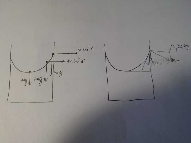

There is a cyllindrical glass (r=0.05 m) full of water. It is rotating around its vertical geometric axis with 3 turns per second. How many centimetres higher is water at the rim than in the centre of the glass . Water rotates together with the glass.
p=ρah
ω=2πγ
a=ω2r
All I know is that the shape of water is parabolic. In the centre there is no additional pressure from rotation, the pressure on the glass is p=ρah, a=ω2r

Start by drawing a free body diagram for a piece of water on the surface.

probably is y=Cx2 ... but I do not know what is C, maybe a/g ... a=17.8 m/s^2, g=10 m/s^2 i do not know, honestly just guessing, as i do not know how to solve it

I do not know what free body diagram is. Sorry. Please explain to me and I will try

Consider a small parcel of water at the surface, at some radius x. If the surface shape is described by y=f(x), what is the slope there? Draw a diagram of the parcel of water and the forces acting on it. Treat the rest of the water as a frictionless solid.

Ok. You left out a normal force, and you need to answer this question
I.e., in terms of x and y.

tanφ =ω2r / g
and dy/dx = ω2r / g
so: y= ω2r x /g ... for r=x I get y= ω2x2 /2g
and I have y if i put r=x!
Right. So what answer do you get?
4,4cm

4,4cm
Using g=10m/s2, yes, but 4,5cm would be a bit closer.
