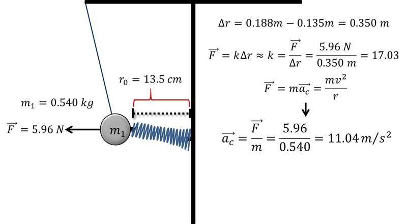

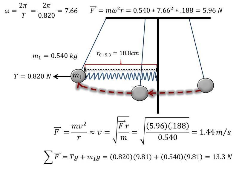

I am in need for some help for a lab report. The issue has happened because there is a lab of 20 students that is being led by a recently retired NASA physicist trying to lead a team of graduate student (or camel jockeys as he puts it) and the lab instructions are being botched horribly. Attached are some photos of diagrams that I have created along with data sheet that was provided in the lab. Can someone let me know if I am at least on the correct path and what the variables that I have pulled from my textbook correlate to with regard to the data sheet provided? Also, the writing and calculations on the data sheet are not my own, I am just using it to give an example of what I am confused of. Thank you.

1) Measure radius with spring disconnected to get an initial radius, then move the place marker 1/2*r away from the initial position (not shown in the pictures due to it being a benchmark stage)
2) Attach the spring between the hanging mass and the rotational shaft on one side, and on the other side attach a string, which is placed over a pulley so that you may visualize the tension force required to stretch the spring to the point [r+(1/2*r)].
*Now that I look at this, the tension force that I had of T=0.820N is incorrect as that was simple the weight, and the new tension force is T=8.24N
3) Detach the weighted string and return the mass to the initial position (spring still attached)
4) Rotate the shaft until the centripetal force is equal to that that of the radius [r+(1/2*r)]. Using a stopwatch, record the time it takes for the apparatus to rotate 50 rotations.
After this, I know that I need to calculate the rotation rate by dividing the average time by 50, then multiple the rotation rate by 2π in order to get ω. This is where I begin to get confused. I am confused in how to make a correlation in between the tension force exhibited by centripetal force and the weighted force that is measured by the benchmark at the beginning of the lab.

OK - so the answer to question 2. was
"The aim of the experiment is to verify the relationship between angular velocity and centripetal acceleration."
To do this you need two independent ways to get the centripetal acceleration.
One you get from the circular motion theory, which you are testing; and the other you get from a more reliable direct method, which has already been well established - like Newton's force law.
The method was to suspend a pendulum from a turntable.
You measure the angular speed and the radial displacement of the pendulum bob.
The radial displacement tells you the centripetal force.
To make the calculation easier - you are spinning the turntable+pendulum so a pre-chosen radial displacement has been produced. This is one where you have measure the force already ... that's what the mucking about with a spring was about.
Initially I thought you were spinning the whole thing with both string and spring attached.
Now I don't think you were supposed to do that so if you did, you have made some extra work for yourself.
