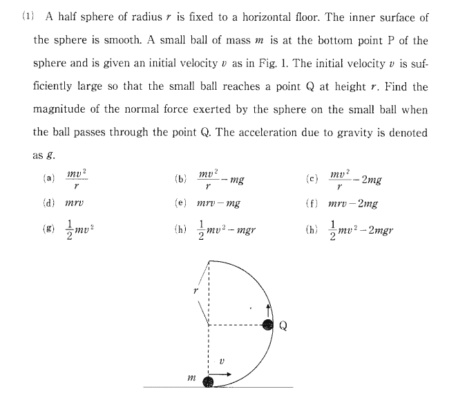

Biloon
F_{c} = \frac{mv^{2}}{r}
I think the normal force would be the magnitude of vector sum of centripetal force and gravitational force. So I did:
N = \sqrt{(\frac{mv^{2}}{r})^{2} + (mg)^{2}}
However, it isn't one of the answer choice. The actual answer is (c), and I have got no clue why it is (c).
I could imagine why answer is:
(a) Since mg is perpendicular to point Q, normal force is only \frac{mv^{2}}{r}
(b) if calculated from the highest tip of the circle...
but where does 2mg comes from!?
Thank in advance.
The -2mg part originally comes from the KE converted to PE.
Try writing an equation for the energy of the ball at Q.
Oh thanks, so we approach this problem using conservation of energy.
let v = initial velocity
We have this at Point Q:
KE = KE' + PE..
1/2mv^2 = 1/2mv'^2 + mgr.
mv^2/r - 2mg = mv'^2/r
We also have Force at point Q:
Fn = Fc = mv'^2/r = mv^2/r - 2mg
Yes that how I got the book answer.
