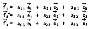

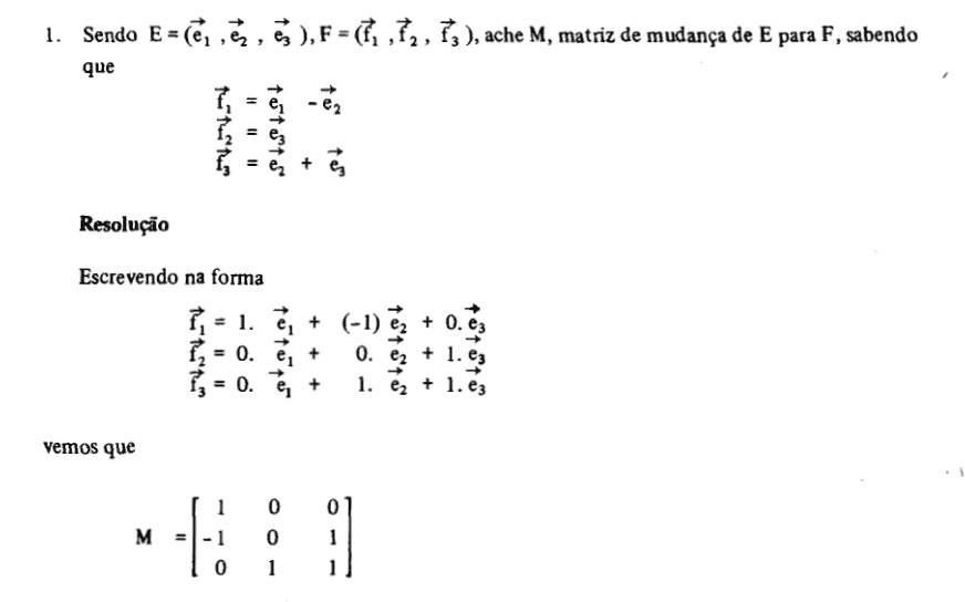

See this exercise: It ask for the matrix changing the basis E -> F
If you pay attention, it write F in terms of E and write the matrix.

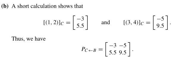

Now see this another exercise:
It ask the matrix B -> C, writing B in terms of C
Which is correct? If it are essentially equal, where am i interpreting wrong?

I think they are different types of transformation matrices. The first transforms the basis vectors, i.e. expresses one set of basis vectors as linear combinations of the other set.
The second matrix ##P_{C\leftarrow B}## transforms the components of a vector written in the basis B to the components of a vector written in the basis C.
For instance, the components of the element of ##\mathbb{R}^2## ##(1,2)## written in the basis ##C## is ##[-3, 5.5]^T## whilst the components of that same element written in the basis ##B## is ##[1,0]^T##. Now note that $$[-3, 5.5]^T = P_{C\leftarrow B} [1,0]^T$$ I was also confused by similar matters very recently, and one of the key take-aways was that it is important to know the exact context of the matrix equation. Is it transforming basis vectors? Is it showing how the vector changes during a linear transformation? Is it transforming components of the same vector between two different bases? They all look similar, but are distinct operations :wink:.

I disagree. Both examples are doing the same thing: converting from one basis to another.
The first example is a bit trickier to see, since the vectors aren't given in coordinate form. If we assume that the basis E is the Euclidean basis for ##\mathbb R^3##, it's a lot easier to follow what's happening.
From the equations given for basis F in terms of E (and with my assumption that E is the standard basis), we have:
##\vec {f_1} = \begin{bmatrix} 1 \\ 0 \\ 0 \end{bmatrix} - \begin{bmatrix} 0 \\ 1 \\ 0\end{bmatrix} = \begin{bmatrix} 1 \\ -1 \\ 0\end{bmatrix}##
##\vec {f_2} = \begin{bmatrix} 0 \\ 0 \\ 1\end{bmatrix}##
##\vec {f_3} = \begin{bmatrix} 0 \\ 1 \\ 0 \end{bmatrix} + \begin{bmatrix} 0 \\ 0 \\ 1\end{bmatrix} = \begin{bmatrix} 1 \\ 1 \\ 0\end{bmatrix}##
So the vectors in basis F are the first, second, and third columns of the matrix identified as M. Using the notation of the second example, ##M = P_{F \leftarrow E}##, the matrix that transforms the basis E to the basis F.
Borrowing from your notation for the second example, and applying it to the first example, we have ##[1, -1, 0]^T = P_{F \leftarrow E}[1, 0, 0]^T##.
