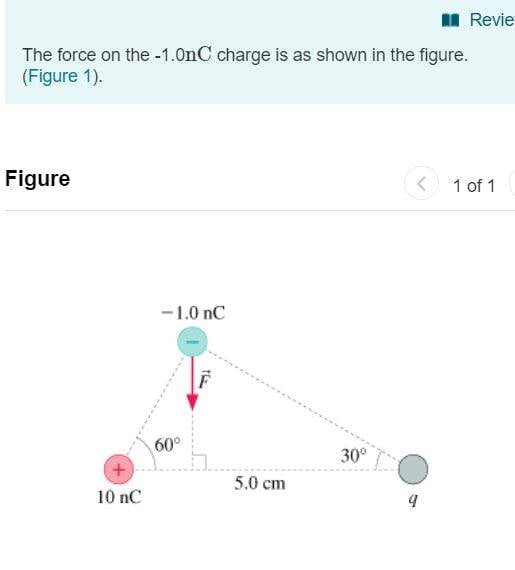

What is the net force on the -1nC charge in this Coulomb's Law problem?

link: https://ibb.co/Xy9s6DR
What is the magnitude of this force?
Coulomb's Law
Trig equations
(.05 m)xcos(60)=0.025m (the distance between the two known charges)
F(between the two known charges)=(9x20^9)(1x10^-9)(10x10^-9)/(0.025)^2=1.44x10^-4
F(that points down)=sin(60)*1.44x10^-4=1.25x10^-4N
The homework system says I got it wrong but I'm not seeing where.

Lilian Chan said:
(9x20^9)
9x10^9
That's only the force between those two charges. The F in the diagram is the net force on the -1nC charge from the other two.
