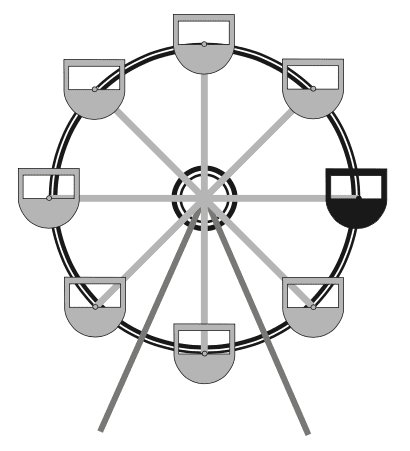

Write and explain the free-body-diagram of the forces acting on a cabin of a Ferris wheel, in a uniform circular motion at the instant in which it's at the same height as the wheel's pivot point.

Hi guys,
Schermata 2021-01-29 alle 16.09.40.pnggiven the "blacker" to be the cabin under consideration,
I firstly wrote its weight force; then, my confusion started when drawing the force applied on the cabin by the structure(##F_{r}##).
I concluded it must have been both counter-acting the weight, and acting as a centripetal force... but I'm quite uncertain about it and I'd appreciate knowing if I'm correct or no.
The path I'm taking, for now, is that vertical component ##F_{ry}## must be equal to the weight, while the horizontal ##F_{rx}## to the centripetal force, resulting thus in an inclined force with respect to the standard vertical direction, pointing in the second quadrant of an ##xy## plane.
What do you think about it? Have I made any mistakes or imprecisions?

That's good. As far as your wording goes, I'd say ##F_{rx}## IS the centripetal force.
When you draw ##F_r## on your diagram, make sure you get its length/direction reasonably accurate. If drawn correctly, then 'by eye' (using the parallelogram method) you should see the vector-sum of ##F_r## and weight acts horizontally.

And if you were asked to draw the FBD for a passenger in the cabin, you would draw an arrow parallel to the one you described above with a magnitude scaled by the ratio of the passenger's mass to the cabin's mass.
And if the passenger held a box of popcorn, ##\dots## you get the picture.
