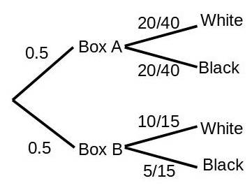

There are 2 boxes. box A contains 20 white balls and 20 black balls. Box B contains 10 white balls and 5 black balls. A box is chosen at random, then a ball is taken at random from the chosen box. What is the probability that the ball is white?

##\displaystyle P(\text{white})=P(\text{box 1 AND white})\,\text{OR}\,P(\text{box 2 AND white})=\frac{1}{2}\cdot\frac{20}{40}+\frac{1}{2}\cdot\frac{10}{15}=\frac{7}{12}##

Hi @Rikudo. A simple probabilIty-tree diagram may help:
Probability of picking Box A and then a white ball is 0.5*20/40.
Probability of picking Box B and then a white ball is 0.5*10/15.
Overall probability of picking a white ball is 0.5*20/40 + 0.5*10/15.
Reply
