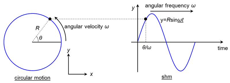

He's probably referring to a diagram similar to this:
(https://xmphysics.com/2023/01/11/appendix-a-angular-frequency-vs-angular-velocity/)

For a harmonic wave (sinusoidal wave), each element of the spring moves in simple harmonic motion (SHM). The maximum speed of a particle moving in SHM can be found from the amplitude and frequency of the SHM. You might need to review this from your study of SHM.

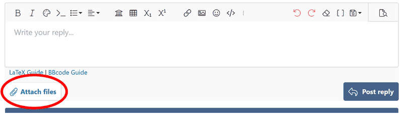

Can someone tell me how to attach the PDF or otherwise insert the pages?
Brian_D said:
I created a two-page PDF with the relevant section of the textbook, including a diagram. Can someone tell me how to attach the PDF or otherwise insert the pages? I tried the "insert image" command, but it would not let me insert a PDF file.
You can attach pdf, but a lot of viewers won’t bother to download it to view it. Better to attach an image.
On my iPad I can click the image button, just left of the smiley button, then tap the "drop here" instruction. It gives me the option of taking a photo.

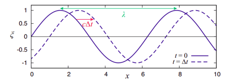

That is the subject of 'Wave Math' (16.2 I expect).
That the wave travels to the right you can see by looking at the argument ##kx - \omega t##: a crest of the moving wave satisfies ##kx - \omega t=n\lambda## with ##n## an integer. Follow the crest: for a given constant ##n##, the value of ##x## has to increase with ##t## to the tune of ##kx = n\lambda + \omega t ##. in other words ##\displaystyle {dx\over dt } = {\omega\over k} ## .
Or -- in other words ##v = 2\pi f / (2\pi/\lambda) = \lambda f##.
(And sure enough, with a plus sign instead of a minus sign the wave travels in the negative x direction.)
A point on the spring has a fixed position on the ##x##-axis. It moves up and down only, so it has longitudinal speed zero (!).
Pick a point, for example with ##x = \lambda/4 ## so that ##kx = \pi/2##. Or ## x = (n+{1\over 4})\,\lambda##. Its transverse deviation is ##y = A\cos(\pi/2-\omega t)= A\sin(\omega t)##. And its transverse speed is ##{dy\over dt } =\omega A\cos(\omega t)##.
And indeed, when t = 0 it has deviation 0 and maximum transverse speed ##A\omega##. :smile:
