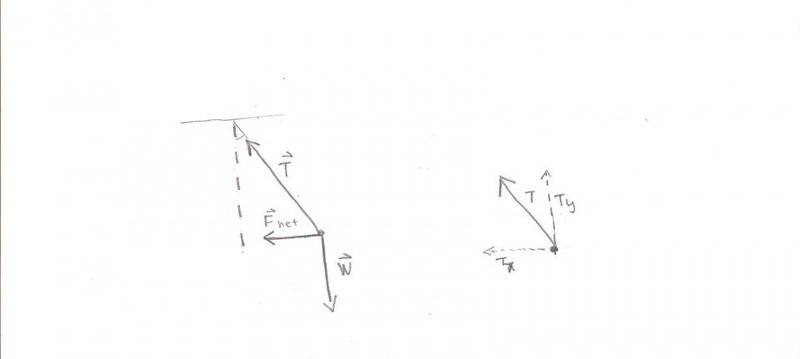

A pendulum traveling at constant speed along a circular path
Determine the angle that the string makes with the vertical.
T[/B]he length of the string was measured to be 60 cm.
The period was measured to be 1.41 s
The frequency was found to be 0.709

How about drawing a free body diagram of the pendulum? Identify all forces acting and apply Newton's 2nd law.

Hand-drawn free-body diagram: a suspended mass on a string at an angle from a ceiling, with tension T along the string, weight W straight down, and net horizontal force Fnet pointing left. A second diagram shows T resolved into components Tx (left) and Ty (up).
I understand that that force (net) = ma = (mv^2)/r
and that mass "cancels out" so Force(net) = a = v^2 / r.
Velocity is not known. Neither is the radius, or angle
(the length of the string providing the tension, the period and the frequency are known.)
I thought that I could solve for velocity, and from velocity, solve for radius, ... but am now wondering if there is enough info to so do
Apply Newton's 2nd law to vertical and horizontal force components separately.
