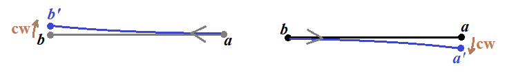

In reality, only in one half-period does the pendulum swing so as to travel clockwise around the circumference, while in the other half-period the swing of the pendulum-ball is in the opposite direction. Therefore, the actual period, time taken to carry out one revolution around the center in a clockwise direction, will be twice as long as [tex]\tau[/tex], that is, [tex]\tau_0= 2 \tau = \frac{4 \pi m}{|qB|}[/tex].
The pendulum will precess clockwise for both half-periods. For example, suppose we're looking down onto the xy-plane and the magnetic field points out of the page. For the first half period, let the particle swing from point a toward point b, as shown on the left below. You can check that the magnetic force deflects the particle upward so that it arrives at point b' instead of b. This corresponds to a small clockwise deflection. Likewise, if the particle swings from b back toward a, for the second half period, then the magnetic force deflects the particle downward. This again corresponds to clockwise deflection.
