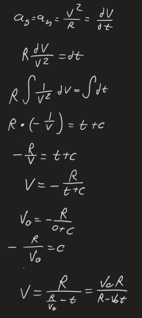

Thanks for your help!
Here is my solution:
