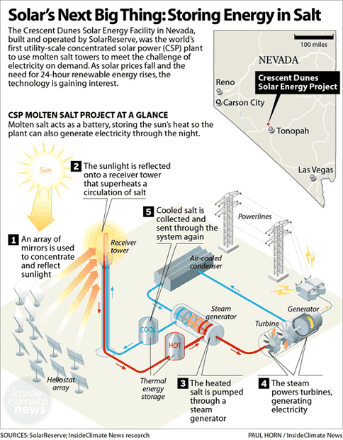

First off, the Ivahpah plant doesn't use salts. (Unless things have changed recently.) It heats up water directly to steam. Maybe she's confused as to which solar plant she's visiting.
The Crescent Dunes Solar Energy Facility, and the Solana Generating Station, do use salts, however.
Figure 1. Real world operation of Crescent Dunes Solar Energy Facility
Anyway, what she says about the salt "boiling" is incorrect. The salt melts into a liquid. The molten salt then heats up water to a boil (creating steam), and the steam runs the turbines. The salt itself does not vaporize.
