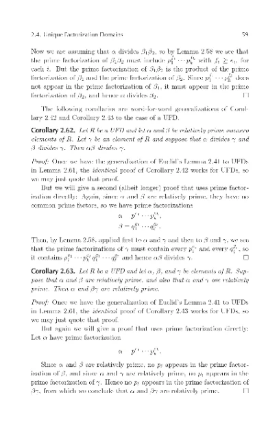

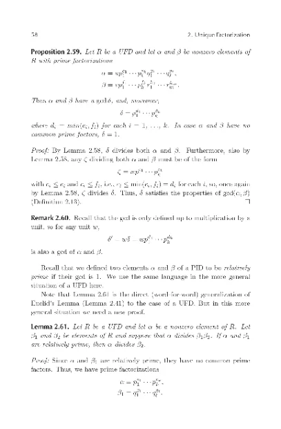

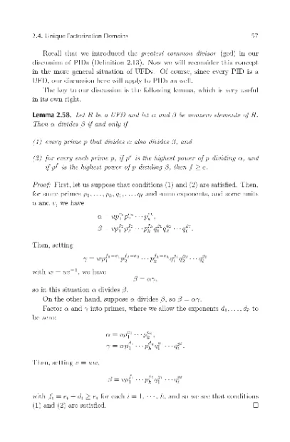

@fresh_42 the proof I rewrote the proof from is adapted from lemma 2.61 in the following screenshots, second and third pages, In it, the author made use of lemma 2.58. In Hubgerford, there are the corresponding theorems to lemma 2.58 and lemma 2.59. As you can see, lemma 2.61, the author just made use of prime factorization, and he only used the corresponding assumption that ##a\mid bc## and the factors within all three integers ##a,b,c##. If my effort in rewriting caused any lack of clarity, that is solely my fault. Also when gcd(a,b)=1, then the prime factorization of a, b, with their respective prime factors ##p_i^{e_i}, p_i^{f_i}##, then min(##e_i, f_i##)=0, which is what i tried to include. If you have trouble reading the pages, let me know. i will try to make it more clear or type out the relevant portion. I also attached a pdf of the three pages.
In my earlier replies, not sure if i changed or deleted it. I said that if we have ##a\mid bc## and gcd(a,b)=1, then the factors of ##a## don't appear in ##b## and so must appear in ##c##, hence ##a\ mid c##. I mean i could ask one of the LLMs to wrote out Lemma 2.61 in mathematical notations, but I want to try it out myself first i mean, I only do that unless I find the notations confusing or unclear, or just plain unintutitive to use in the sense of the precise notation doesn't really convey what I think it conveys in plain English.
(CMS Treatises in Mathematics) Steven H. Weintraub - Factorization_ Unique and Otherwise-A. K...webp
@fresh_42 Here is the typed up version of what is in the screenshots in post 23,
##\textbf{Lemma 2.58:}## Let ##R## be a UFD, and let ##\alpha, \beta## be non zero elements of ##R##. Then ##\alpha## divides ##\beta## if and only if
(1) every prime ##p## that divides ##\alpha## also divides ##\beta,## and
(2) For every such prime ##p,## if ##p^e## is the highest power of ##p## dividing ##\alpha## and if ##p^f## is the highest power of ##p## dividing ##\beta##, then ##f\geq e.##
##\textbf{Lemma 2.61:}## Let ##R## be a UFD, and let ##\alpha## be a non zero elements of ##R.## Let ##\beta_1## and ##\beta_2## be elements of ##R## and suppose that ##\alpha## divides ##\beta_1\beta_2.## If ##\alpha## and ##\beta_1## are relatively prime, then ##\alpha## divides ##\beta_2.##
##\textit{Proof:}## Since ##\alpha## and ##\beta_1## are relatively prime, they have no common factors. Thus we have prime factorizations ##\alpha=p_1^{e_1}\cdots p_k^{e_k},\beta_1=q_1^{g_1}\cdots q_l^{g_l}.## Now we are assuming that ##\alpha## divides ##\beta_1\beta_2##, so by ##\textbf{Lemma 2.58}## we see that the prime factorization of ##\beta_1\beta_2## must include ##p_1^{f_1}\cdots p_k^{f_k}## with ##f_i\geq e_i,## for each ##i##. But the prime factorization of ##\beta_1\beta_2## is the product of the prime factorization of ##\beta_1## and the prime factorization of ##\beta_2.## Since ##p_1^{f_1}\cdots p_k^{f_k}## does not appear in the prime factorization of ##\beta_1##, it must appear in the prime factorization of ##\beta_2##, and hence ##\alpha## divides ##\beta_2.##
When trying to express al the english sentence using mathematical notations, I was trying to make sure i got all the technical details correct.
