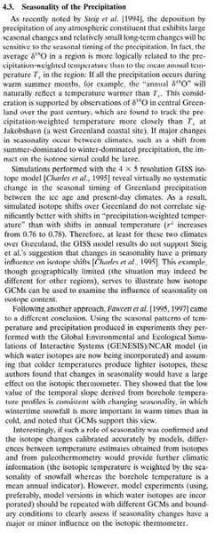

Let's have a look at http://www.ipsl.jussieu.fr/GLACIO/hoffmann/Texts/jouzelJGR1997.pdf , page 17, copied here for convenience.
Scanned journal page, section 4.3 'Seasonality of the Precipitation', printed two-column text discussing isotope thermometer and Greenland ice core records.
Obviously the isotope thermometer only works when it snows and every year is the weighted average of the mixture of the isotopic 'light' cold winter snow and isotopic 'heavy' warm summer snow (see also fig 1 of Jouzel et al). If the ratio in summer and winter snow changes then so does the average isotope signature. For instance if the warm summer snows diminishes in an arid period, only the cold winter snow remains, giving a cold bias. Jouzel et al acknowledge that real time observations confirm this but revert to models to conclude that there are no reasons to assume such a shift for the ice ages. So models right, reality wrong?
However, their models were as good as the knowledge of those days, when Siberia was a blank spot, assumed to be covered by a lot of ice most likely. However, the modern fieldwork in Siberia has generated quite a different picture, which should put some question marks to the accuracy of these assumptions and consequently the models.
So it seems that seasonalitly of precipitation could have played a role after all.

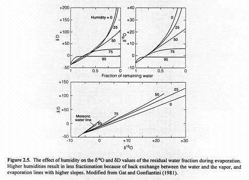

So let's follow an air mass generating water vapor from the ocean. The first process we encounter is the fractionation of the water molecules during the evaporating, interestingly enough we see:
Figure 2.5: three graphs of delta D and delta 18O of residual water against fraction of remaining water or delta 18O, with curves labelled 0, 25, 50, 75 and 95 for humidity.
Evaporation from an open-water surface fractionates the isotopes of hydrogen and oxygen in a manner which depends on a number of environmental parameters, the most important of which is the ambient humidity.
Evidently, the more arid the stronger the fractionation, hence in low humidity conditions the water vapor is already more in heavy isotopes than under moist conditions.

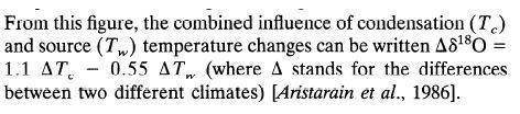

In the attempt to quantify isotope fractionation one would expect elaboration upon this. However in para 3.1. page 26,478 (7) we find:
Printed equation text from a paper: From this figure, the combined influence of condensation (Tc) and source (Tw) temperature changes can be written Δδ18O = 1.1 ΔTc − 0.55 ΔTw, where Δ stands for the differences between two different climates [Aristarain et al., 1986].
They identify source temperature and condensation temperature, apparently as independent variables, whereas I have indicated that there is a relation between those two, since source temperature is the more prominent variable for the absolute moisture of the air above it, which in turn determines the ‘temperature of condensation’ or rather “dew point”.

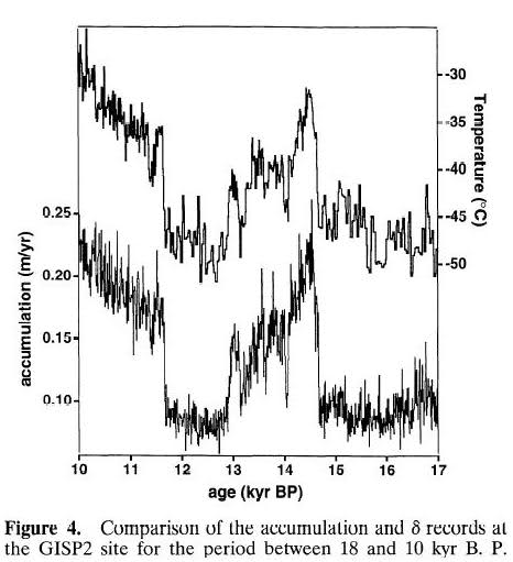

But things get more compelling if we have a look at fig 4 (para 3.1.), where they compare the isotope signature with the snow accumulation rate:
Line graph comparing accumulation (m/yr, left axis) and temperature (°C, right axis) against age (kyr BP) from 10 to 17 kyr BP, with both records showing abrupt shifts near 11.6 and 14.6 kyr BP.

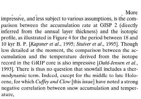

The extreme high correlation is explained thus:
Scanned page of printed journal text, a paragraph beginning 'impressive, and less subject to various assumptions' and discussing GISP 2 accumulation rate and isotopic profile comparisons.
However the most direct cause for variation in accumulation is not addressed, as hinted before, changes in humidity regime. So it appears that fig4 supports the alternate idea here that absolute humidity at the moisture source could be (one of) the major contributor to the isotope signature in the ice cores.
So if that was to be true, we should be able to test that, we have seen already in the other thread that the Northern Hemisphere temperatures in the timeframe 14.5 – 17.5 thousand years ago, were up, while the Greenland isotopes as seen here, were down, challenging the isotope thermometer.
How about that second low isotope period roughly between 12.7 and 11.6 thousand years ago?
