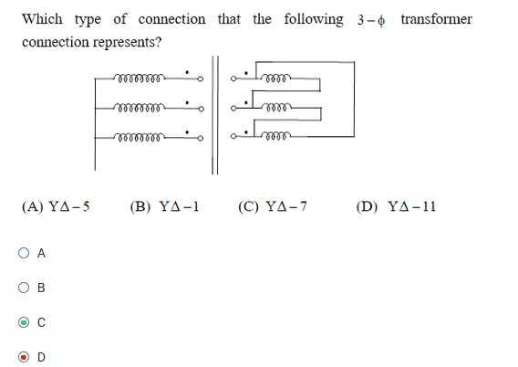

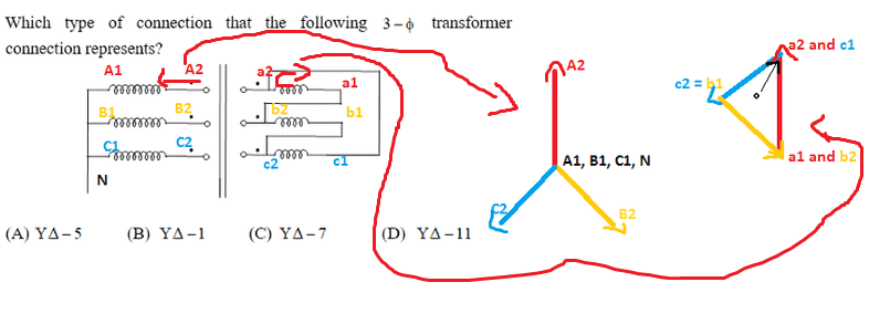

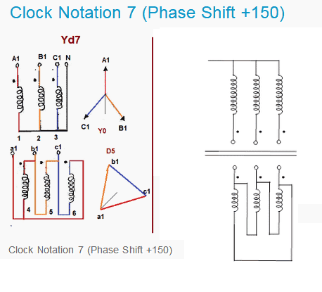

Clock Notation of Star-Delta 3-phase transformer
26 replies · 9K views
jaus tail
613
48
Dot is A2.
A1-A2 of star is in phase with A1-A2 of delta
I'm getting answer as Y-Delta - 1. Assuming Y is HV.
How is C right answer?

I think for Yd-7, the dots on L.V (Delta connected) winding should be on right side of each winding.
That is the first time I have seen the terminals drawn against the magnetic laminations, with a greater separation between the primary and secondary.
But here are some others without the laminations.
https://www.kullabs.com/classes/subjects/units/lessons/notes/note-detail/3507
Notice the polarity of the secondary is reversed which puts a 180° shift in all phases.
That may convert 1 o'clock to 7 o'clock.

I got this phasor diagram
Left is from google:
http://electrical-engineering-portal.com/understanding-vector-group-transformer-1
Right is the one in practice test. I don't think right one is YD-7. Please help me. Exam is in 10 feb. Thanks.

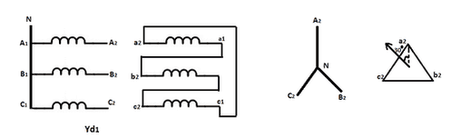

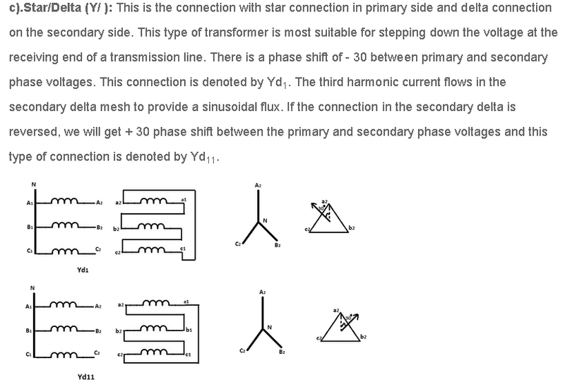

I've never encountered that kind of notation before. Do the odd numbers 1 5 7 11 refer to phase shift somehow?
From that link you posted, Star-Delta is either YD1 or YD11

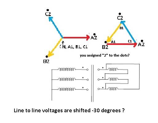

So, drawing yours i get (pardon my awkwardness with Paint)
Looks to me like YD1 per that KULLABS reference.
Aha ! found another reference...
Starting from the very basics i get same phase shift as you got, thirty degrees behind.

old jim

My logic at the moment is ...
Phasors rotate counter-clockwise mathematically. A2 is the reference pointer so it points upwards at 12 hours. It will be followed by B2 at 4 hours and then C2 at 8 hours. The phasors are lettered or named clockwise because they are rotating anticlockwise.
Swapping the end connections to all primary or secondary windings, introduces a 180° shift which would be called Yy6. Reversing both will cancel back to Yy0.
The secondary voltage is in phase with the primary, so phasor positions at time zero may be rearranged, but not the orientation of the phasors, when for example the connections are changed to make the y secondary into a delta. That is neglected by many references and leads to major confusion. You got it right in your paint, the diagram you cut and posted got it wrong. Why is that so difficult?
I float the neutral in the middle of the delta as my phase origin.
There are two ways of doing that transformation.
1. You can connect a2 to c1 etc, which makes a Yd1 group, secondary leads primary by 30°.
2. You can connect a2 to b1 etc, which makes a Yd11 group, secondary lags primary by 30°.
All i did was pay close attention to labeling and add them head to tail , as we were taught decades ago.
Hmmm
He sure did get it wrong, didn't he ? That's ahead. Thanks, i missed it.
i was taught if you're rigorous in labeling you'll come out okay. That's what i did in that Paint sketch.

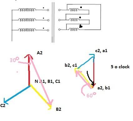

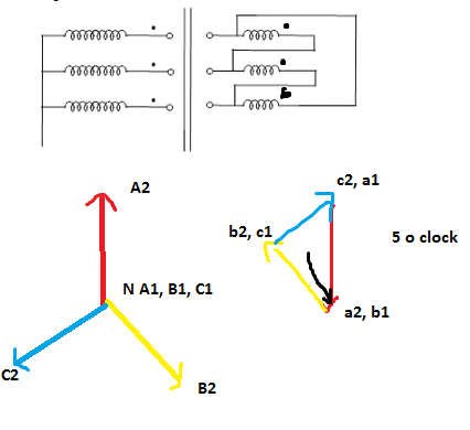

I tried a hand at YD5
Is this right?
jim hardy said:
Where does book put A1 and A2 on primary and secondary ? Same place you did, or A1 on left both primary and secondary ? That'd reverse the secondary connections as @Baluncore suggested.
Gotta be rigorous in labeling. If textbook didn't label with rigor it's student's choice and a textbook error
Stick with the basics.
Book has only drawn YD1 and YD11 and not labelled anything. just dots. I found labels on google.

jaus tail said:
Is this right?
Add your numbers to the windings ? Then its labelled with rigor.
Vab is shifted ahead 210 degrees ? On a clock face, advancing from 12 by 210 degrees would put the hand at 7 o'clock.. (unless it's 24 hour clock).

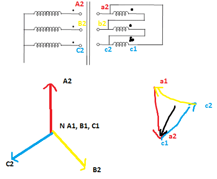

Yeah a2 is actually c1. I named wrong at delta triangle. This gives 7'o clock now.
I was taught to label voltage From - To , ie voltage from Neutral to A is Vna .
Voltage from A to Neutral is Van.
Draw your phasor with tail at FROM and head at TO.
So Van points one way. Vna points opposite.

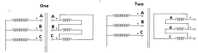

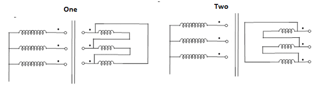

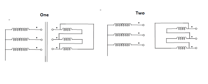

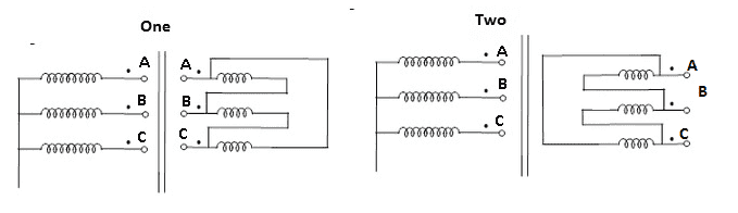

@jim hardy
As per your rules will the two diagrams below have different clocks / phase shifts?
As per what I've studied till now, there must not be any difference in clocks of above two connections. But I need to be sure.
They are the same because the dots are consistent, the dots show the arrow head end of each phasor. BUT there is still one unknown. You must be consistent, because you do not know if the windings should be labelled A,B,C, from the top to the bottom, or from the bottom to the top. That means the rotation could be forwards or backwards. It is not possible to know the direction of rotation from the dots alone.
Without a specification of the order of the winding's phasors, the question of Yd1 or Yd11 becomes impossible to answer, because there are two ways to wire a delta, or to label the diagram, forwards or backwards.
jaus tail said:
@jim hardy
Great question .
Clearly they'll behave the same when measured at their dotted ends. But -- As "Author In Charge of the drawing" you're free to assign your labels this way, Not that you would but somebody else might.
Left one, secondary Vab is voltage across A winding. Right one, it's voltage across B winding..
Label carefully. .

Just to clarify:
I intended this. The labels on secondary right side are at terminals, and not near to the core. So I guess book is wrong in post#1. My rules in post#4 are correct. Thanks.
I think you have it now.
This worries me somewhat
jaus tail said:
5) Use Dots for
----Now if in primary current is entering winding from A2 terminal and in secondary current is leaving winding from a2 (figure out from dots), then A1-A2 and a1-a2 are in phase.
----But if in primary current is entering winding from A2 terminal and in secondary also current is entering winding from a2, then A1-A2 and a1-a2 are 180 degree out of phase.
Dots are simpler than that.
The dots tell you which ends of a winding pair go positive (with respect to other end of that winding) at any instant.
In your most recent drawing, when A end on the primary winding goes positive, A end on the secondary winding also goes positive. With respect to other end of same winding .
Same for the B's, and the C's.
In both your One and Two .
The dots guide you in assigning your labels so that your phasor diagram will work out nicely.

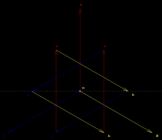

Here is a phasor diagram showing a primary star with the two possible secondary delta configurations.
The Neutral is on the zero volts line. Winding ratio is 1:1
There are actually 4 possible combinations. The delta r line can face downwards as well.
