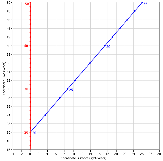

Ok,perfect that what I mean.Lets say that man-woman are 20 years old. My question is:
If man counts 10 year for him(he will be 30 years old),and if for him woman's clock counted 5 years,woman for the man will be(25 years old).
That is the same from woman's point. She will see herself 30 years old,but man 25 years old.What happenes here??

That's exactly what happens. Any time dependent process (the aging of the human body, sand falling through an hourglass, the decay of a sample of radioactive material, the motion of the Earth around its axis and around the sun, ...) can be used as a clock, and they are all equally affected by time dilation.
But there is still no paradox here; read what I said above about the relativity of simultaneity. Although in man's frame, his 30th birthday celebration is simultaneous with woman's 25th birthday celebration, but it does not follow that in woman's frame her 25th birthday celebration is simultaneous with his 30th birthday celebration.
To get a paradox, you would have to bring them together at the same location, so that we could compare their ages at the same time in the same frame. You can't do that if they're both moving at a constant speed relative to one another; and if you drop that assumption to bring them together, that's a different situation, the classic and much-discussed twin paradox.

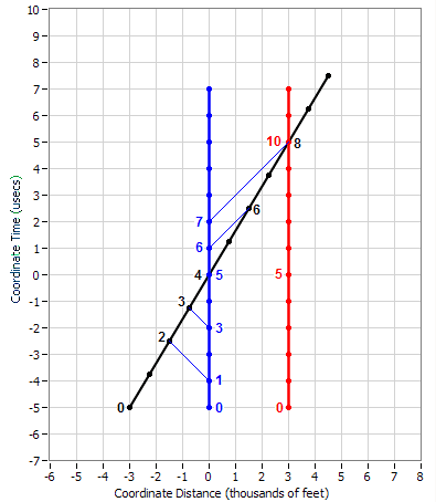

Let me illustrate with some spacetime diagrams. Since you described a scenario where the man and the woman are 20 years old when he takes off in a spaceship, I will first show a diagram depicting their mutual rest frame prior to launch and then the blue man takes off at 0.866c leaving the red woman behind. The dots represent 1-year intervals of time for both of them. We can call this the woman's rest frame:
So like you said, when she is 30 years old, he is 25 years old. I have included some more comparisons: when she is 40, he's 30 and when she's 50, he's 35. He accumulates age at one-half the rate she does in her rest frame.

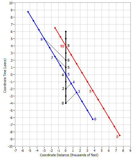

Now let's look at a portion of the man's rest frame while he is traveling away from the woman:
Again, just like you said, when he's 30 years old, she is 25. Their ages are symmetrical when compared from their own rest frames.

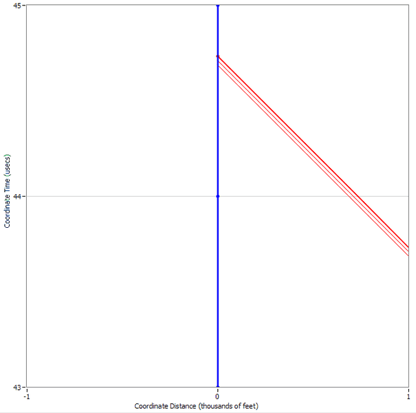

Hepic said:
Yea,I see but if man look at the mirror he will see hisself to be old,but If woman see him via "phone",or something else the man be younger for her??
That is a bit strange :P

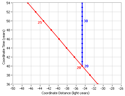

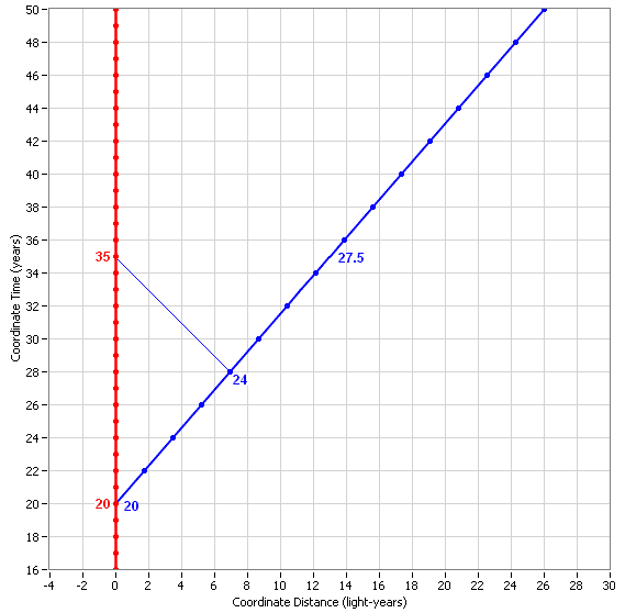

I don't think it's strange if you see it on a spacetime diagram. Here is an example when the red woman sees the blue man via "phone" with a radio signal that traveled at the speed of light:
When she is 35 and he is 27.5 (in her rest frame), she can't actually see him at that age, rather, she will see him as he was at age 24, whether it's via "phone" or whether she is just looking at him via a suitable telescope. This is a 4 to 15 ratio.

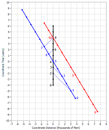

Hepic said:
Something final. Paradox of twins will happen only if spachip turns and come back again at earth. That gravitational force will make the man to think that woman's clock runs very fast.
I am correct?? If yes,why?

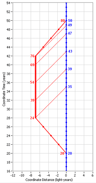

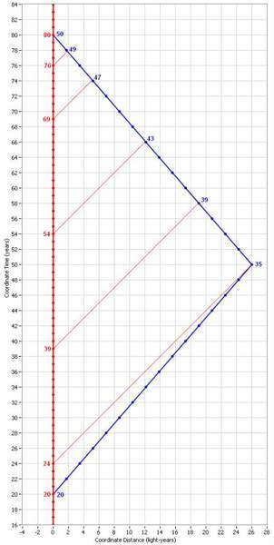

Although we don't have to explain this with gravity, you are correct that the man will observe (not just think) that the woman's clock runs very fast after he turns around. Just as the woman saw the man's clock running at 4/15 of her clock's rate, he sees her clock running slower than his by the same 4/15 ratio during the outbound portion of his trip. But as soon as he turns around, he starts seeing her clock running faster than his own by the inverse of the ratio, namely 15/4.
Here is a spacetime diagram of the entire trip in the rest frame of the woman indicating the signals going from the woman to the man showing that prior to his turn-around, he sees her clock running at 4/15 of his own and then after he turns around, he sees her clock running 15/4 of his own:
Now I want to show you a non-inertial diagram for the rest frame of the man during the entire scenario based on the radar method of determining the distance to the woman as a function of the man's own clock:
You can see that this diagram correctly depicts the signals traveling at c from the woman to the man and agreeing with all the observables in the inertial rest frame of the woman.

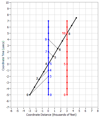

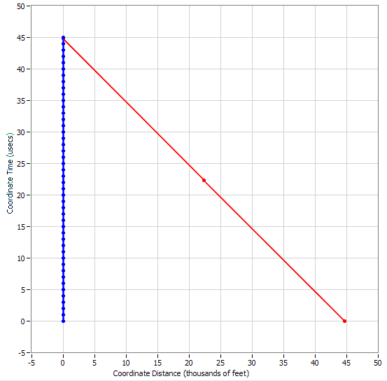

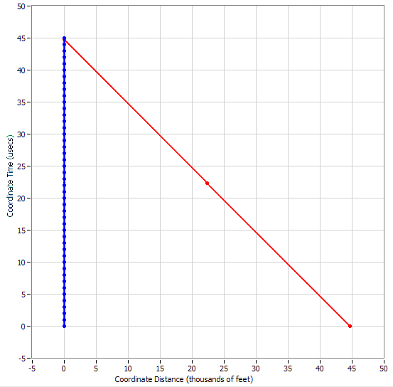

Let's take a specific example to help understand what's going on here. Let's assume that the rocket ship with astronaut A (shown in black) is traveling at 0.6c with respect to observer O's rest frame and that one of observer O's clocks is colocated with him (shown in blue) and the other one (shown in red) is 3000 feet away. All clocks start out at zero in observer O's rest frame. Here is a spacetime diagram showing the "fly past" of the rocket ship past the two clocks. The dots represent 1-microsecond intervals of time on each clock. I'm defining the speed of light to be 1000 feet per microsecond:
The first thing to note here is that as the rocket ship is approaching observer O, observer O sees the astronaut's clock running at twice the rate of his own and then as it goes past observer O, he sees it running at one-half the rate of his own clock.
Then note the times on all three clocks at the two "fly pasts". The astronaut measures a time interval of 4 microseconds between the two "fly pasts" since his clock was at 4 for the first "fly past" and at 8 for the second "fly past". Observer O's first clock measured 5 at the first "fly past" and 10 at the second "fly past" so he calculates a time interval of 5 microseconds. So 'To' is greater than 'Ta' since 'To' equals 5 and 'Ta' equals 4.
Now I want to repeat the same spacetime diagram except with light signals to show how the black astronaut sees the blue observer's clock running at twice the rate of his own before the "fly past" and half the rate of his own after the "fly past":
Next I want to transform the events (the dots) from observer O's rest frame to the astronaut's rest frame and we will see that all the observations and measurement remain the same. First is the diagram showing what observer O sees of the astronaut's clock:
And finally the diagram that shows what the astronaut sees of observer O's clock:
I hope this clears up all confusion. Hulberj, does this make everything clear to you?
